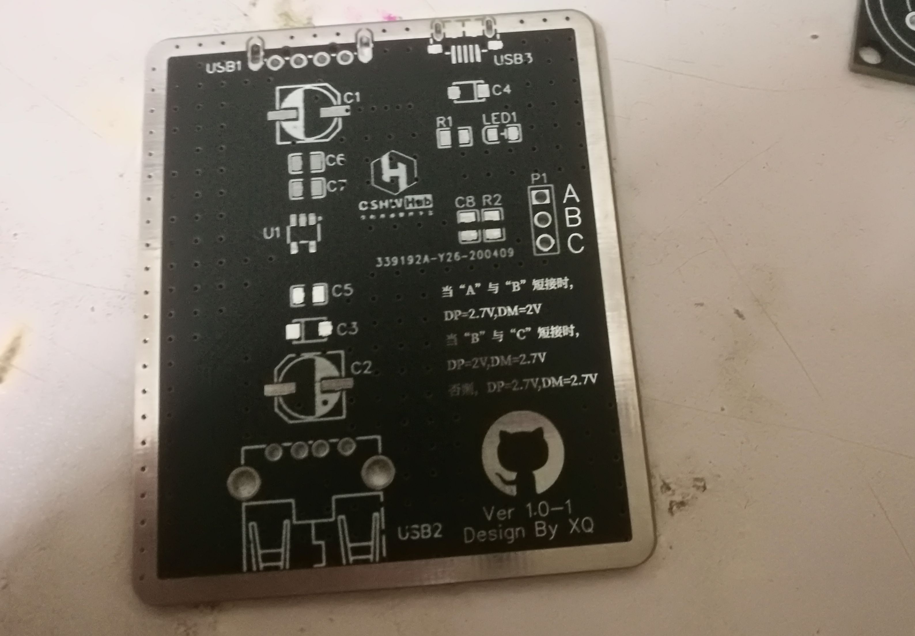

Solution verification board based on SE2515-HF
This project is a solution verification board based on LCSCC115749 SE2513-HF
log
2020-4-17
I did a welding test and found that it was inconsistent with the datashit (yes). In order to avoid chance and make the experiment accurate and universal, I changed 3 ICs and found that the output voltages were exactly the same (accurate to the hundredth), as shown in the picture: QQ picture 20200420062707.jpgQQ picture 20200420062740.jpgQQ picture 20200420062711.jpgAnd this is the voltage value given by datashit:
AB short circuitBC short circuitNo short circuit
DM to ground voltage2V2.7V2.7V
DP to ground voltage2.7V2V2.7V
Plan to test again after replacing PCB
2020-4-22
After replacing the PCB, I found that the voltage was almost the same
