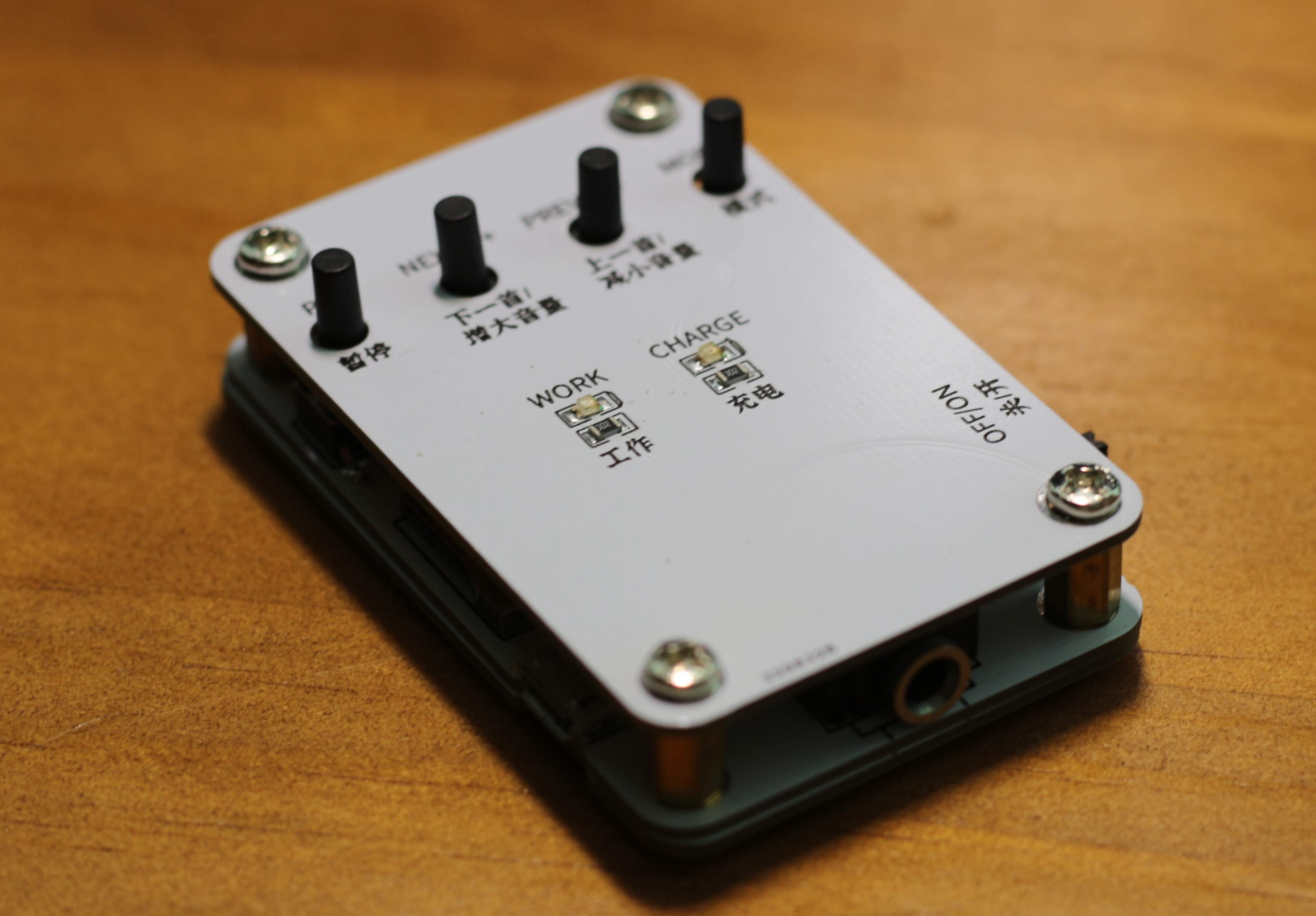

【Creative PCB】MP3-AC6905
B station video
Function:
  1. Connect the mobile phone to MP3 via Bluetooth, plug the speaker into the MP3, and play music through the mobile phone. It can be used to change it to a Bluetooth speaker.
  2. Save music to TF card and insert TF card to play music
  3. FM radio (can be used, but because there is no FM antenna, it is useless. You need to search hundreds of times on the balcony to find a station, and the sound quality is slightly better)
    Instructions:
  4. Turn on
  5. Long press the button to adjust the volume
  6. Plug in headphones
  7. Press the mode button to switch signal sources (default Bluetooth mode)
  8. Connect the mobile phone to the Bluetooth signal emitted by the MP3 (the Bluetooth name depends on the store where you purchased the chip)
  9. Short press the button to switch songs
Precautions:
  1. Depending on the store, some chips default to the maximum volume when powered on, so it is recommended to turn down the volume first and then put on the headphones.
  2. When buying a chip, be sure to ask the store whether the chip has a program burned into it before purchasing it. Do not buy one with the word "original" on it, which generally does not come with a program.
  3. It is recommended to choose polymer lithium batteries, which are slightly thinner. If the length, width and height are not suitable, the battery will be forced to be exposed.
