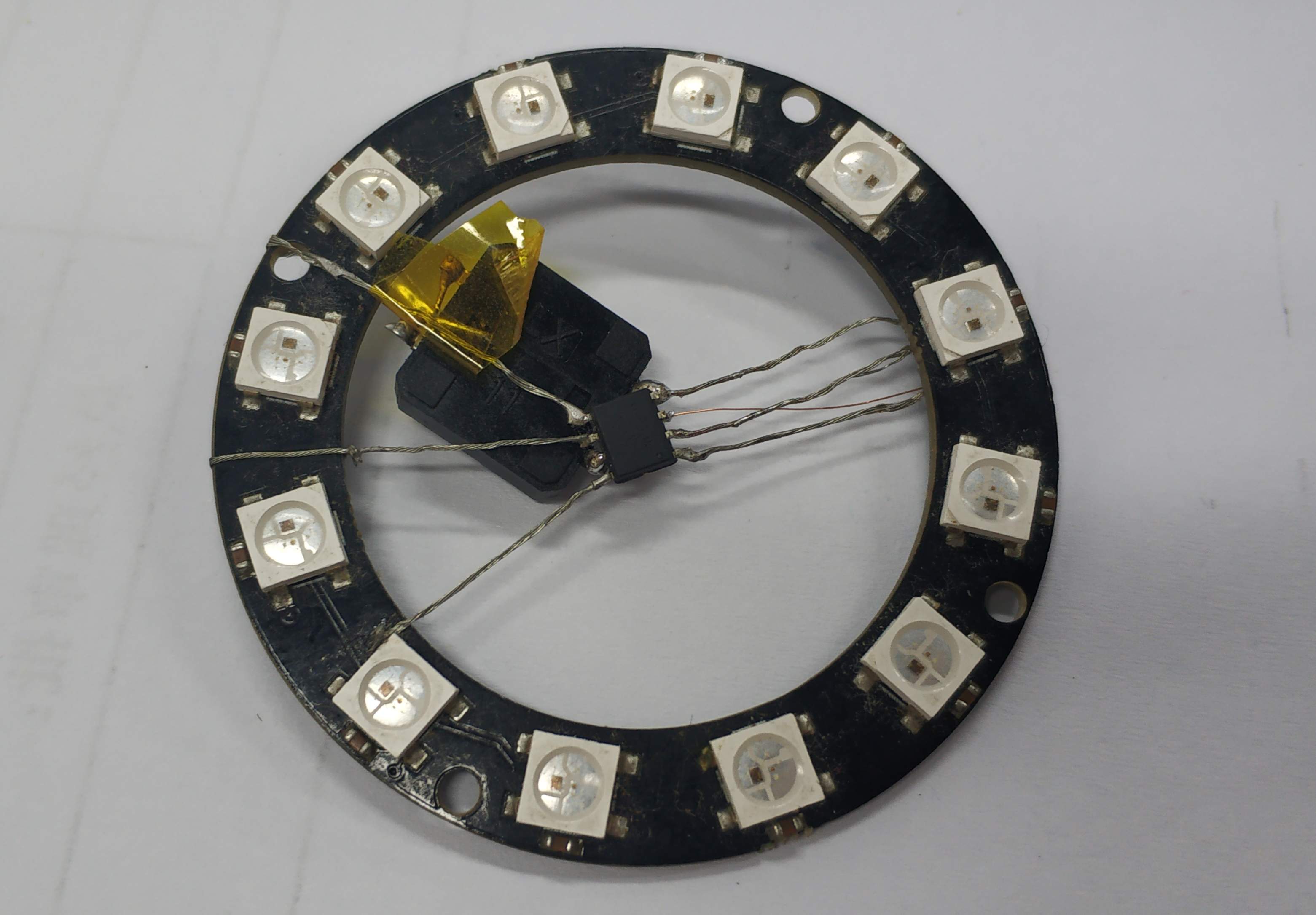

WS2812-STC development board
When switching buttons, the shutdown power consumption is 9uA. If the buttons are replaced with touch modules, the shutdown power consumption is 1mA. If the indicator light on the touch module is removed, the shutdown power consumption is 25uA.
