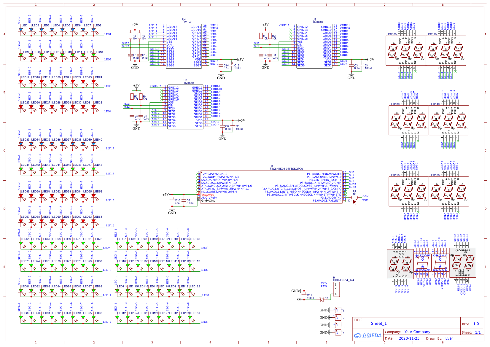

0. The main control uses STC8H1K08 and displays TM1640.
1. This module is only used with the display module, and the module uses serial port communication.
2. The data collected by the host is displayed on this module.
3. The module supports extended multi-level series connection.
4. The module is updating the schematic diagram and pcb. Please do not use it directly for the time being.
5. Module design note: The 9th and 10th bits of the second digital tube driver chip are connected and can be cut off during soldering.
6. The 9th, 11th and 12th bits of the module are up and down reverse, used to display the clock. You can modify the program to display forward, or directly modify the hardware chip driver pin.
Module test, normal display is normal, running water light is also 666
