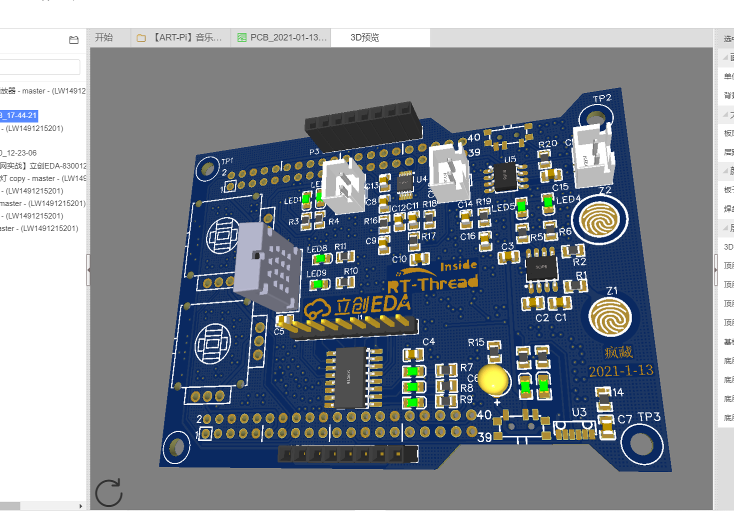

I saw a lot of awesome people on the Internet who made small boards that play music. I thought it was very practical, so I followed them. It happened that this time Lichuang had an extended version event, so I took this opportunity to try it out. Maybe Many places are not handled well, and there are more or less problems. But after all, this is the first time to build such a board, so I am going to fix it with a learning attitude! Note: This time it seems to be a bit off-topic. I accidentally adjusted a lot of modules, which seems a bit off-topic. Maybe it’s because I want to give ART_PI more functions! Also, I don’t have much contact with Lichuang, so it’s good to get more familiar with it through this drawing board.
Main functions : The extended version is equipped with an LCD (OLED, TFT) that can directly display the status of the output songs; with the addition of a joystick and touch buttons, you can select and control some settings, and the joystick can also be used to do many other things. things; a hard decoding chip was chosen to convert the data from the microcontroller into an analog signal. Considering the power issue, a power amplification chip was used to greatly amplify the signal, and finally a speaker was connected for external amplification.

Problems encountered when drawing PCB and schematic diagrams
1. When drawing the schematic diagram, I feel that the selection of devices is a bit random. It is difficult to find a particularly suitable device. In addition, I do not know the parameters of some devices very well.
2. The schematic diagram can be enhanced in the layout and routing, so that the PCB layout is easier to carry out when passing parameters.
3. When drawing a PCB, the main thing is layout and wiring. This time I felt that my wiring was very bad, very random, and looked very messy. I didn’t find a good solution, and the board was beaten like a wasp.
4. The wiring diagram on the board (really messy, Wori)

3D model
