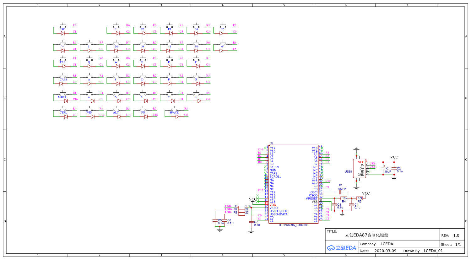

Quoting Lichuang's official 87 keyboard to make a split 78 keyboard (left)
In the early stage, I received a set of split 78 keyboard casing from Xianyu, and I have always wanted to play with it by making my own PCB. I just happened to create an 87 keyboard, so I scanned the shell and positioning holes to generate a positioning plate. I am new to electronics and don’t understand a lot of things. I have been making changes for about a week (the GND automatic connection is not easy to connect, and I didn’t know what copper laying means in the early stage). The file on the left is modified as follows (I don’t know whether it is right or wrong. Please help me read it. (Bottom) 1. Because there is no need for lights, I deleted the circuits of the three lights, and deleted the light resistors and lights (I don’t know whether it’s right or wrong). 2. When GND is automatically connected, the wires always fly, so just add them in the schematic diagram. All GND points are marked with × to indicate that they are not connected, and then use through holes to connect the copper GND network during PCB production (not sure whether it is right or wrong) 3. Do the official names of 0.1U and 0.1u capacitors refer to 0.1 μF capacitors? 4. What are the ohms of the two official resistors R7 and R8?
In the picture, C1 and C2 are two power supply filter capacitors. In addition, R1 is used as the current limiting resistor of LED1. When the power is on, the LED lights up (this is the power indicator light)
  • Main control circuit
image.png In the picture above, X1 is the crystal oscillator circuit, which can be directly connected to the crystal oscillator. The size can be 6M or 12M ; R4 and R5 are used as reset circuits, and R6/7/8 are used as USB circuits. LED2-digit case lock indicator, LED3 is the scroll lock indicator. Since the 87 keys do not have small numeric keys, a non-connection indicator is added to the Num pin of the numeric lock to indicate that this pin is not used.
  • key circuit
image.png There are several small issues that need to be paid attention to in the button circuit. The first is that the direction of the diode is from the R direction to the C direction. If the button is connected reversely, the button will not be triggered. If you find that there is no response when pressing the button during the test, you can check whether the diode Weld it well (you can directly short-circuit it to test the key function); in addition, the role of the diode here is to provide full-key rollover and cannot be omitted.
