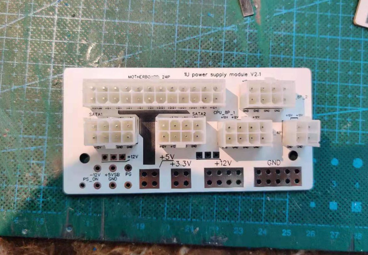

It has two CPU 8pins and one CPU 4pin.
The other two 8pins are used to connect SATA and Big 4D.
The two holes on the board are suitable for Delta DPS-500YB power supply.
! ! ! ! ! Please pay attention to the different line order when using! ! ! ! !
Please carefully check the line sequence and whether the output power supply is normal before getting on the machine, otherwise there will be fireworks when you power on! ! !
**V1.0 Draw casually
**V2.0 24Pin SATA line sequence modification, adding windows and bridge holes
Note: There is a problem with the seat packaging of the V2.0 version and needs to be modified.
##This version is invalid##
**V2.1 seat package has been changed to 5569 and the solid pin is still being verified on the actual machine.
During the test, it was found that the pad opening was too small and could not accommodate two 18awg wires.
There is a problem with the 4Pin CPU socket line sequence definition
V2.1 version basic verification successful
Tips: Try to use a high-power soldering iron when welding
**V2.2 4Pin CPU socket modification and wiring hole enlargement
