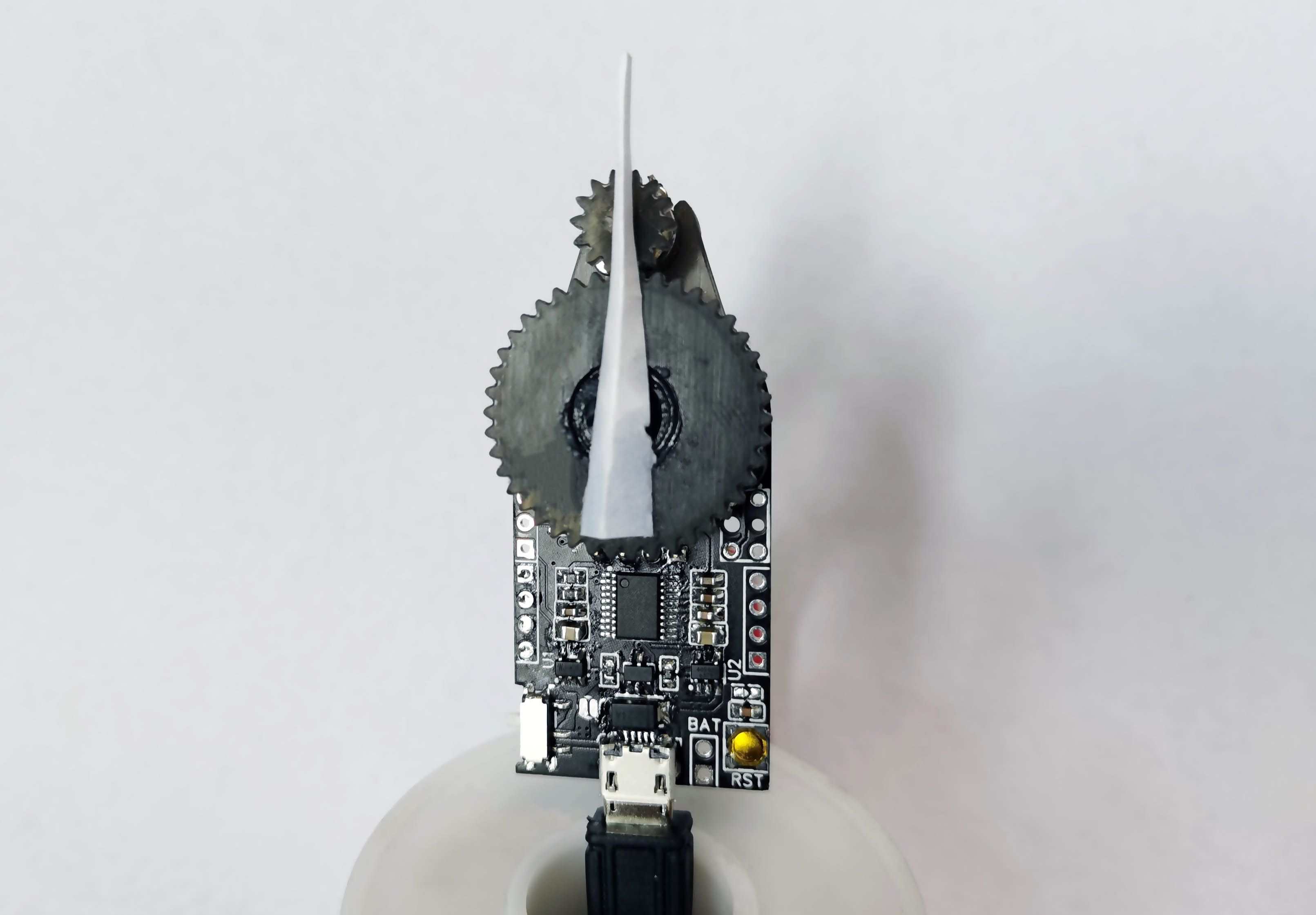

The stepper motor based on STC microcontroller drives the mechanical clock, the rotating potentiometer detects the hour hand position, and the Hall detects the minute position.
  • Based on STC8H1K08 master control
  • Stepper motor drive
  • Rotary potentiometer position detection
  • Lithium battery charge and discharge management
