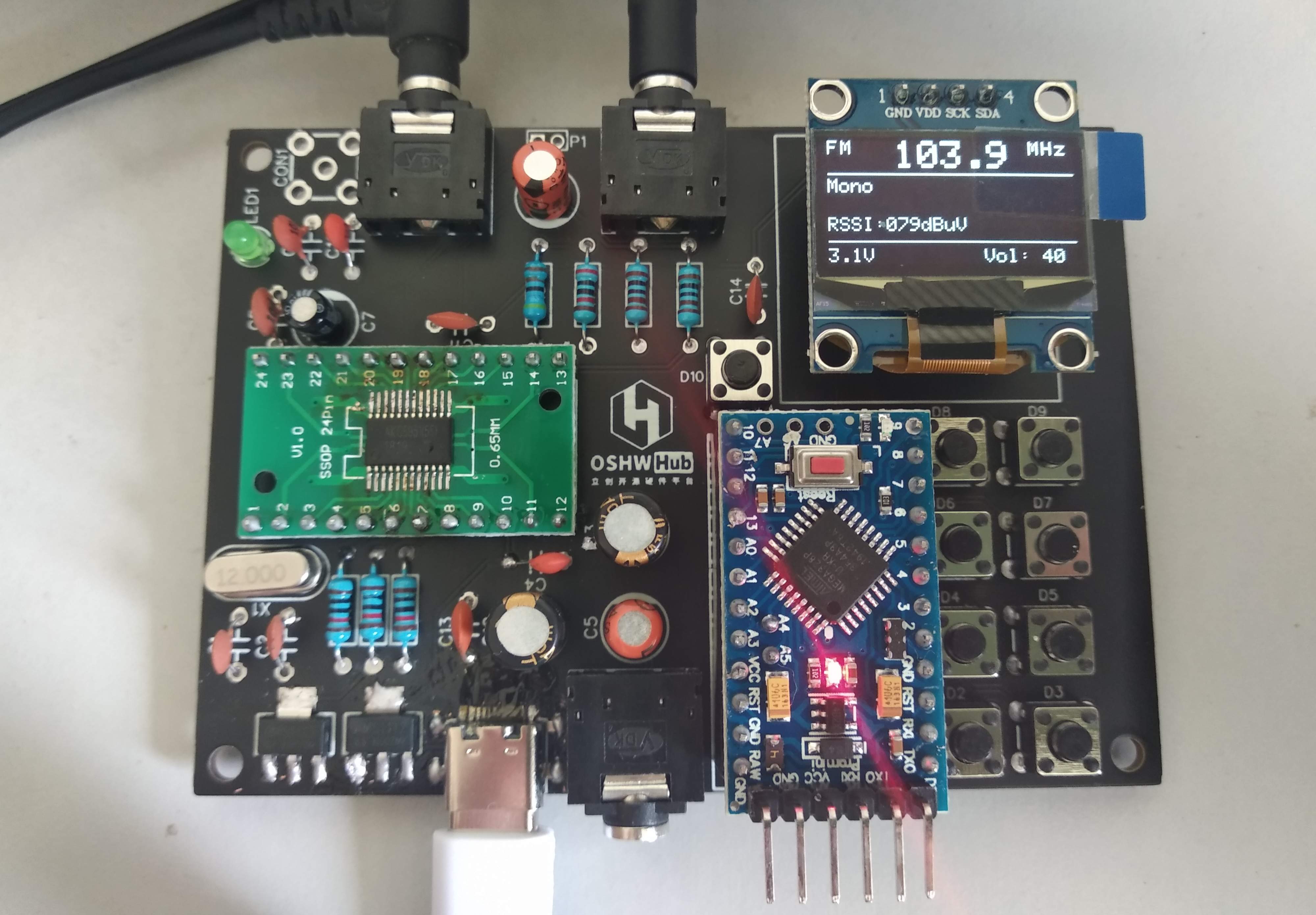

This project is intended to provide a baseboard based on the AKC6955 radio DSP and Arduino pro mini, so that everyone can make their own programmable radio . 9 digital key interfaces are reserved for function selection, and Arduino is used as the main control to facilitate development.

7.25 project progress: The board is ready and has been welded. Picture: QQ picture 20200725161138.jpgQQ picture 20200725163514.jpg Circuit board changes: The circuit board before 7.24 was missing the arduino power supply. It has been added first, and the type-c has been replaced with a more commonly used in-line package, which has been optimized. FM receiving part wiring
A problem was discovered during testing
Warning! Problem description: The FM receiving part has a high probability of poor reception. After investigation, it was found that the ground wire and the FM receiving line have AC coupling characteristics. The earphones are grounded through the capacitor and will also bring signals to the FM receiving end and receive the sound. Speculation:
  1. The wiring of the FM receiving part overlaps vertically with the copper layout or the distance is too small, resulting in AC coupling, which is highly unlikely. Improved in versions after 7.25
  2. The solder mask layer falls off during soldering, and a large area of ​​copper is laid, causing a short circuit between GND and some lines, which is very likely. This time, the solder mask layer fell off easily (the temperature of the soldering iron did not exceed 300 degrees), and there were at least five peelings, causing the copper to be exposed. I personally feel that this is the most likely cause. Solution: No copper laying. The copper PCB for this project has been deleted.
  3. The DSP chip is damaged. There is a small probability, because there have been successful receptions. The green indicator light in the picture indicates that there is a signal and the frequency has been locked.
