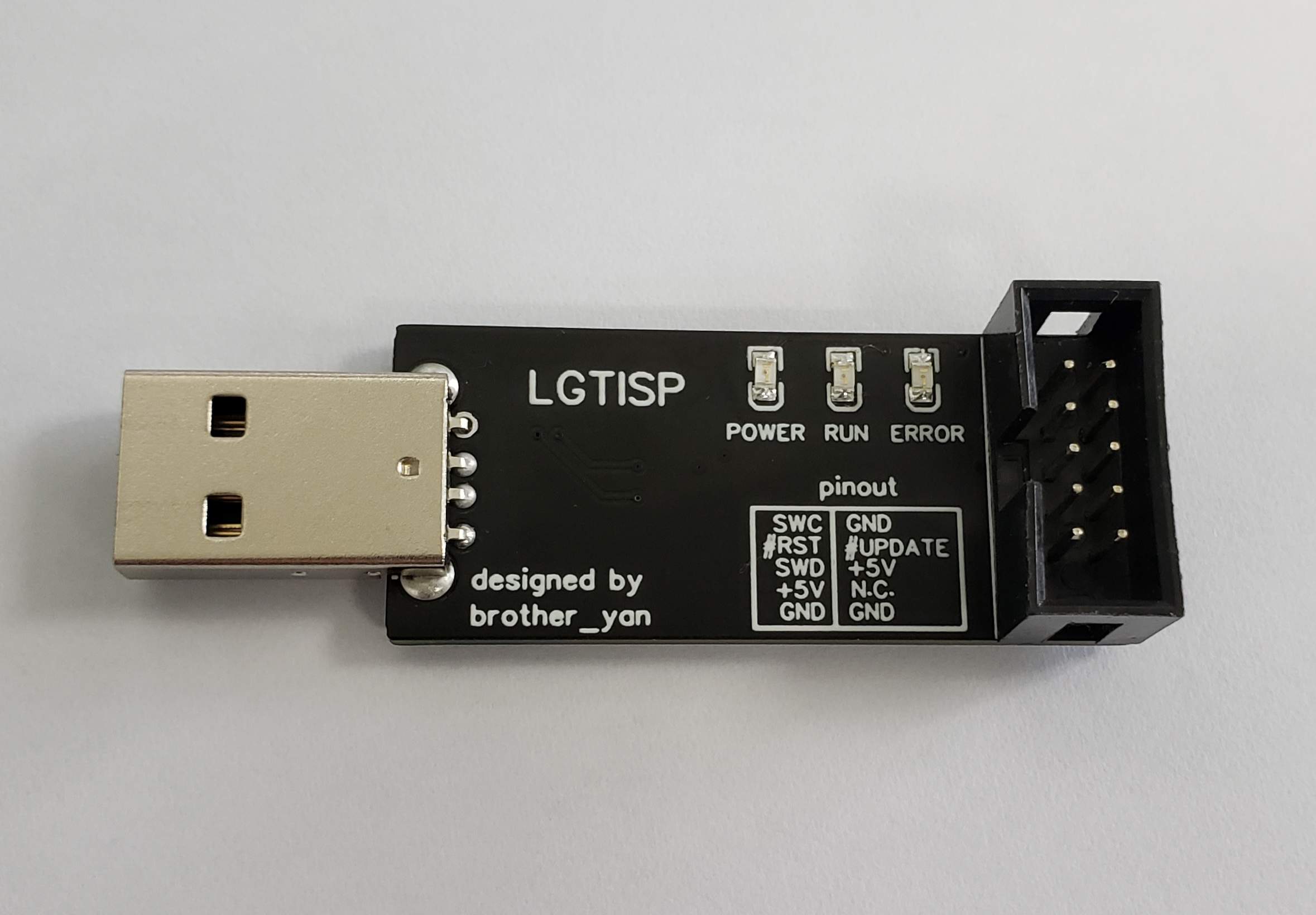

This project is a programmer for LGT8Fx8P/D, used to burn firmware ( .hex/ .bin) into the LGT8Fx8P/D chip
Introduction
  • Hardware supports burning LGT8Fx8P/D chip
  • The microcontroller is equipped with a bootloader, which can easily upgrade the firmware of this programmer. You can use my firmware (only supports LGT8Fx8P, supports reading flash when the power is not cut off), or the official firmware, or even the firmware written by yourself.
  • Pin definitions are compatible with the latest official emulator (SWDICE mkII v2.0)
  • Except for the LED lights, USB plugs, and programming sockets that display status, all components are placed on the bottom layer, and there are detailed silk screen instructions on the top layer. beautiful
  • There are three status indicators for power (POWER), operation (RUN), and error (ERROR) to facilitate observation of the burning process.
  • Compatible with AVR ISP download protocol, the host computer can use it as AVR ISP
  • Flash content can be read without power interruption (the official programmer does not have this function!)
  • Can read the unique ID of the chip (the official programmer does not have this function!)
  • Heavy! ! ! The myth that lgt microcontroller cannot read flash has been solved! ! ! Currently, all flash except the first 1k can be read, but the first 1k flash will be erased (the official programmer does not have this function!)
  • My firmware supports mega328p. Burn my firmware into Arduino Nano and other boards, and it can be used as well.
  • My firmware is open source on github !
  • low cost

schematic.png This programmer is based on Arduino design. This programmer adopts the solution of USB to serial port + lgt8f328p microcontroller. The USB to serial port chip can use CH340C. It is recommended to use CH340G+12MHz crystal oscillator to make the baud rate more accurate. The DTR of CH340 is connected to the RESET pin through a 0.1uF capacitor, which is compatible with the Arduino download method. The lgt8f328p microcontroller uses an external 16MHz crystal oscillator to avoid the problem of excessive baud rate errors caused by excessive errors in the internal RC oscillator. The pull-up resistors of SWC and SWD can be soldered, and it is recommended to solder a 10k resistor.
Update part of the circuit description
When the host computer opens the serial port, the DTR pin sometimes changes in level, which causes the microcontroller to reset. During normal use, you do not want the microcontroller to reset and enter the bootloader. RESET should be forced to VCC. When upgrading the firmware, you need to use RESET to enter the bootloader to complete the firmware upgrade. At this time, you need to release the forced pull-up of RESET. In order to be compatible with the official upgrade logic: the #UPDATE pin is connected to GND to upgrade the firmware. When the #UPDATE pin is left floating, it can be used normally and cannot upgrade the firmware. A circuit consisting of Q1, Q2, R2, and R3 is designed. When #UPDATE is floating, Q1 is turned on, and the G electrode voltage of Q2 is 0, so Q2 is also turned on, which means RESET is forced to pull to VCC; when #UPDATE is connected to GND, Q1 is turned off, and the G electrode voltage of Q2 is VCC. Therefore, Q2 is also cut off and RESET is no longer forced to be pulled up.
