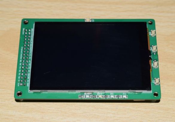

Introduction
This project is a supporting screen display kit for the STM32H743Ix/F767Ix core board . In addition to providing a 3.5-inch IPS-TFT touch screen, it also provides an onboard ST-Link Debugger and 4 additional buttons.
characteristic
  • Directly plugged into the core board, the size is the same as the core board
  • Screen 3.5 inches, IPS-TFT, resolution 320x480
  • 5-point capacitive touch (GT911)
  • Onboard ST-Link V2.1, providing serial port, debugging and USB storage download functions
  • One reset button, 4 user buttons
  • 4 LED indicators to indicate the status of ST-Link and serial port
Precautions
  • The headers on both sides can meet the requirements by using 2x14p patch 2.54 spacing headers. When welding, pay attention to aligning with the USB interface side.
  • JP1 and JP2 jumpers are serial port jumpers. If you need to use the onboard virtual serial port function, they need to be shorted.
  • JP3 and JP4 are SWD debugging interface jumpers. If you need to use the SWD debugging function, they need to be shorted.
