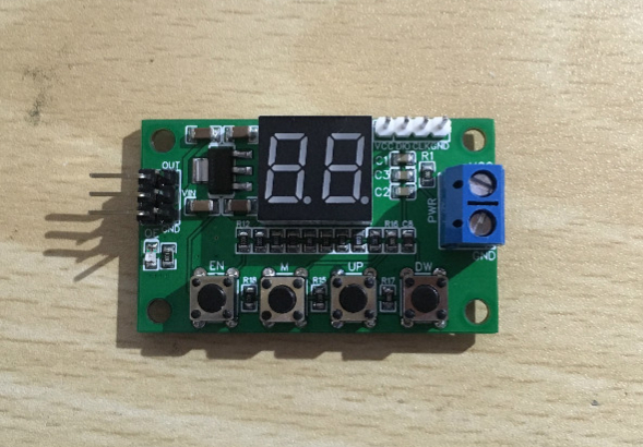

Physical picture
Physical picture: IMG_3692.jpg
Cooperate with ESC brushless ESC to drive the hard disk main motor IMG_3691.jpg
