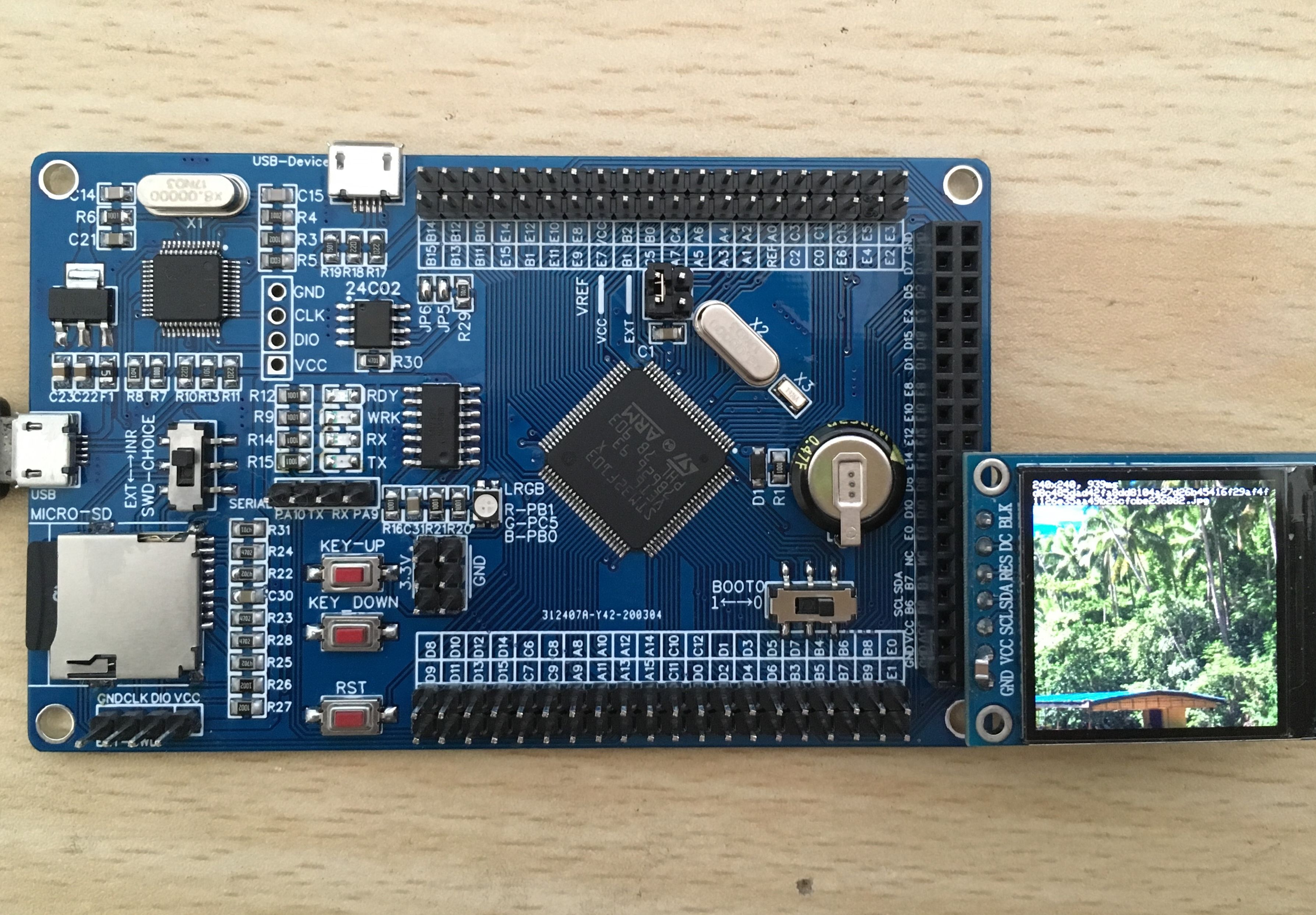

STM32F103/205/407Vx small development board
The smallest system board based on STM32F205VE, compatible with STM32F103Vx and STM32F407Vx. Onboard ST-Link V2.1 integrates debugging, serial port, and USB download.
[V5.2 version update (5/24/21)]
  • Add a default pull-up resistor to the CS Pin of SPI-Flash
【V5.1 version update】
  • Fix silk screen error
【V5.0 version update】
  • Optimize the circuit design. Now all GPIOs are mapped to at most 1 peripheral, and there will be no IO conflicts.
  • Optimize circuit layout
  • Added a set of power headers to power peripherals
  • The RBG lamp is now driven by an op amp (voltage follower mode) to reduce the impact on the high-frequency signal output by the IO port.
  • Add EEPROM chip (AT24C02 256Byte) for fast storage of application data. It is no longer necessary to use the internal Flash to simulate EEPROM, reducing wear and tear on the internal Flash.
  • Add SPI-Flash to meet the need for persistent data storage.
  • The LCD interface has been redesigned, retaining support for most finished modules on the market, while improving scalability. Now it is compatible with 16bit and 8Bit 8080 interface LCD screen modules.
  • Both EEPROM and SPI-FLASH can be enabled or disabled via jumpers.
  • Fixed some bugs and can now better support STM32F103Vx and STM32F407Vx.
  • Mounting holes have been added for easy positioning and installation.
  • Optimize the silk screen and make the prompts clearer.

Proofing actual picture:
Welding finished product picture:
SD card reading experiment + FSMC driver ILI9225 LCD screen (content of the attachment routine)
