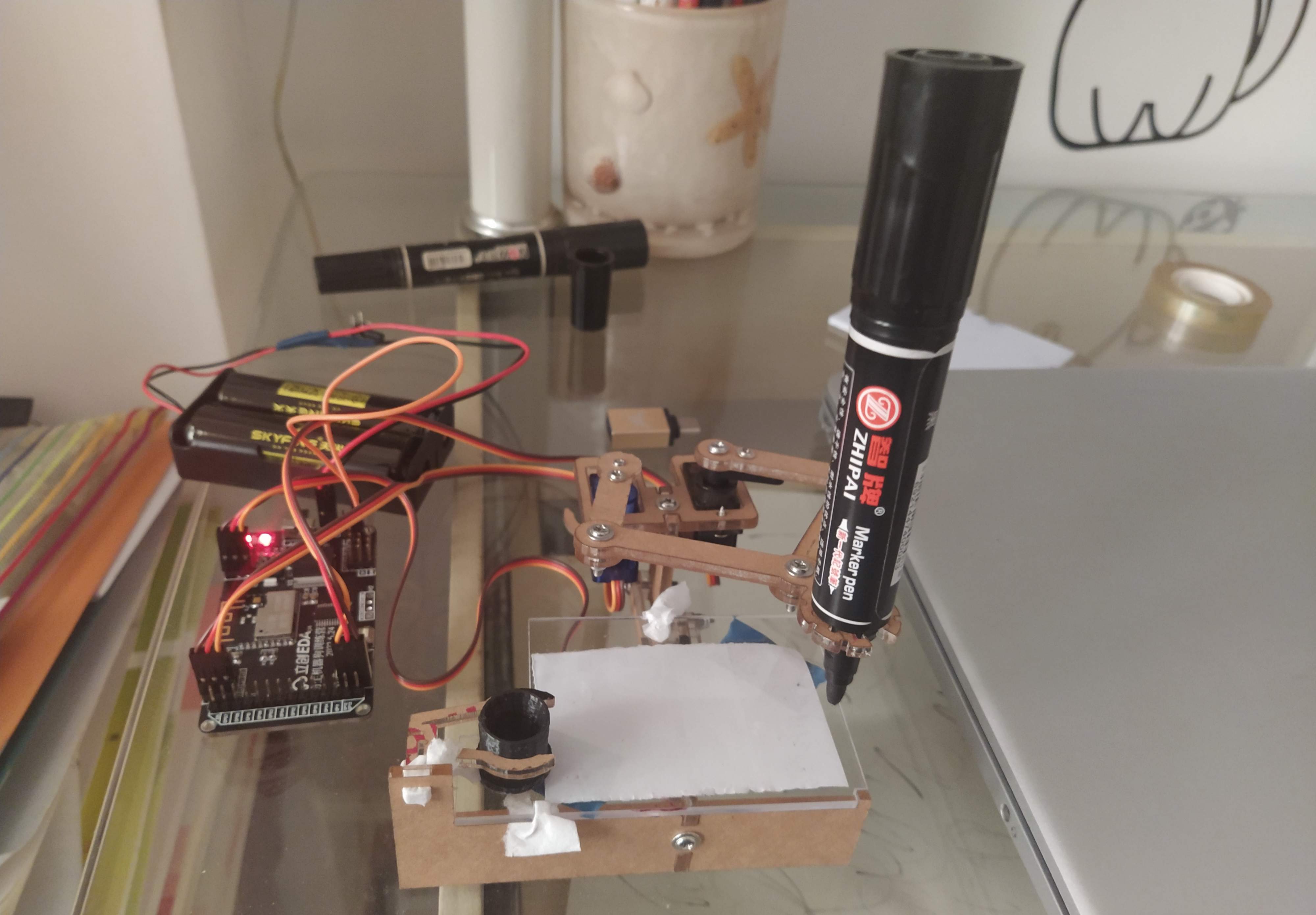

Fundamental:
The LM1084S-5.0 chip outputs four channels of 5V voltage to power the servo, one of which is transferred to the AMS1117-3.3 chip to output two channels of 3V3 to power the Hi3861 and PCA9685PW chips. The main control Hi3861 controls the PCA9685 to output three channels of PWM signals through I2C, thus Control the steering gear to realize the function.
Function implementation:
Draw pictures and write time in real time
Materials (except BOM):
Small clock structure: 3mm acrylic cutting version (the cost of a certain treasure is about 20 yuan)
3 servos (mg90s metal gear 180°)
Two 18650 batteries and one battery box (purchase by yourself)
A large-headed pen (needs to be consistent with the pen grip of Xiaojian Zhong structure)
An erasable pen cap (needs to be matched with a large pen)
Some screws and nuts
Material list and reference purchase link: https://docs.qq.com/sheet/DWGxocU1aalRJS0Z2?tab=9e4zer

Assembly of the little cheap clock:
Software part:
genki_web_plotclock.h Lines 15-18 of code change the pins of the servo signal line here.
The 91st line of code in genki_web_plotclock.c can modify the information of the web page after connecting to WiF, such as adding or subtracting some functions. When adding, you must also write parameters in the corresponding function keys; the 459-482 lines of code can be modified. The angle of each step of turning on the servo is the parameter of SERVO_BOTTOM_PORT.
Precautions:
Please use Hiburn.exe to burn the firmware program.
See the attachment for the code and burning tools.
VMware Workstation 16 player virtual Linux system, then download the Clion compiler, first clone the complete environment code, then open it with CLion, copy the plotclock directory of Xiaojiazhong, and copy it to the  complete environment following directory ohosdog/applications/genkipi/app (note Comment out dog_py in BUILD.gn)
At the same time, replace libdtpython.a in device/itcast/genkipi/sdk_liteos/build/libs/libdtpython.a (the libdtpython.a file is in the project attachment)
After the compilation is completed, find the Hi3861_wifiiot_app_allinone.bin file under the ohosdog/out/genkipi/genkipi file, copy it, put it  in the same file as the Hiburn.exe burning file, open  Hiburn.exe and burn it.
