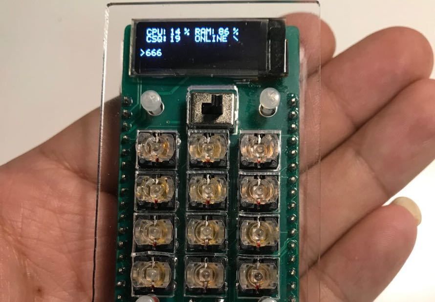

2.2 Display and indicator light functions
  • There is a 128X32 OLED display screen above the status indication panel, which is used to display the current status of the terminal and the received control instructions.
  • The first line shows CPU usage and memory usage. Since the RTOS system adopted does not have the concept of task priority, long-term 100% CPU usage will cause the system's underlying services to fail to execute normally and cause a crash and restart. High CPU usage caused by too frequent instruction sending should be avoided. RTOS systems do not have the concept of virtual memory. The memory usage cannot exceed 100% at any time, otherwise it will cause overflow and unpredictable results, usually crash or restart.
  • CSQ in the second line represents network signal quality, ranging from 0-31. The larger the value, the greater the signal reception strength. Due to the advanced 4G encoding method, data communication is generally possible if it is above 10, and stable transmission and reception can be achieved if it is above 15.
  • The NET in the second line represents the networking status. The Yap terminal has the function of multi-link simultaneous networking. Currently, it supports simultaneous connection of UPWS, MQTT, and Alibaba Cloud. When the corresponding network interface is successfully connected, the corresponding font will be displayed. , if there is no connection, "-" will be displayed
  • The last line is the control command display line. When the terminal receives the network command, it will display the command. Due to memory limitations, the screen only supports English characters, and Chinese characters are replaced with "*"
  • There are 12 keyboard lights in the center of the screen. If you press the corresponding number button or click the number button on the remote control APP, the corresponding keyboard LED will light up. Since the digital port of the terminal and the keyboard are reused, an expansion port is used to connect to the external module for communication. The LED corresponding to the port will flash accordingly.
  • There are two indicator lights below the panel, of which the red one is the charging light. When the light is on, it means charging. Charging must be started first. When this light goes off, it means the battery is full. The green one is the power-on indicator light, which lights up when the computer is turned on normally.
