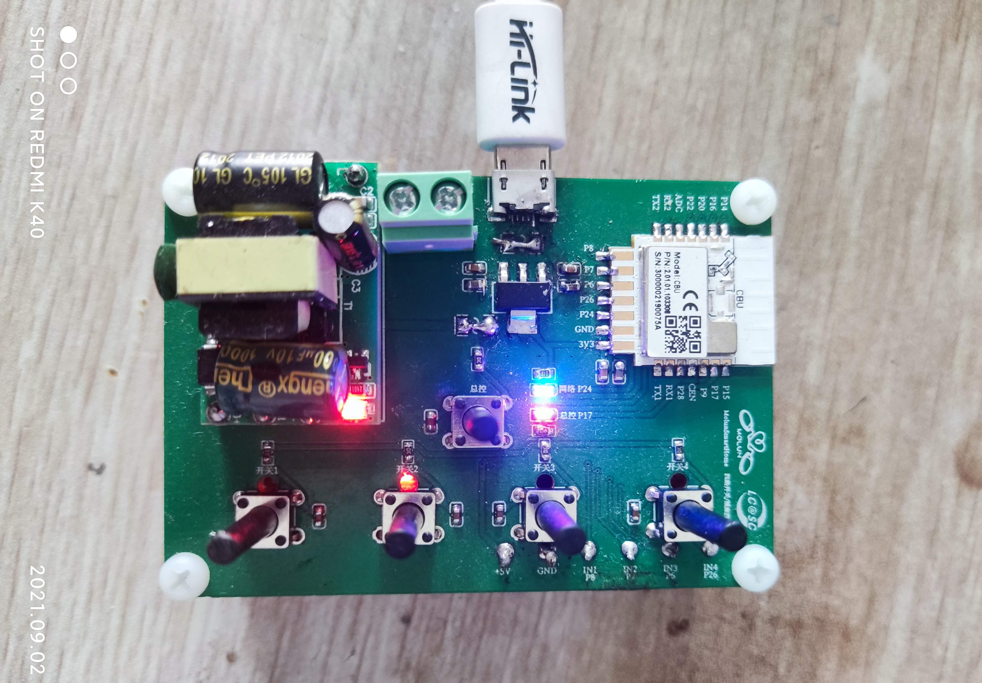

Tuya CBU module SOC development-free solution is simple and easy to use! The module can be configured with four-way switches or four-way strip firmware.
The relay is a four-way red board relay produced by Aubao. It has a MicroUSB interface on the board and can be powered by a data line. If you want 220V direct power supply, weld a 220V to 5V module (AMS1117-3.3 is welded on the module)
