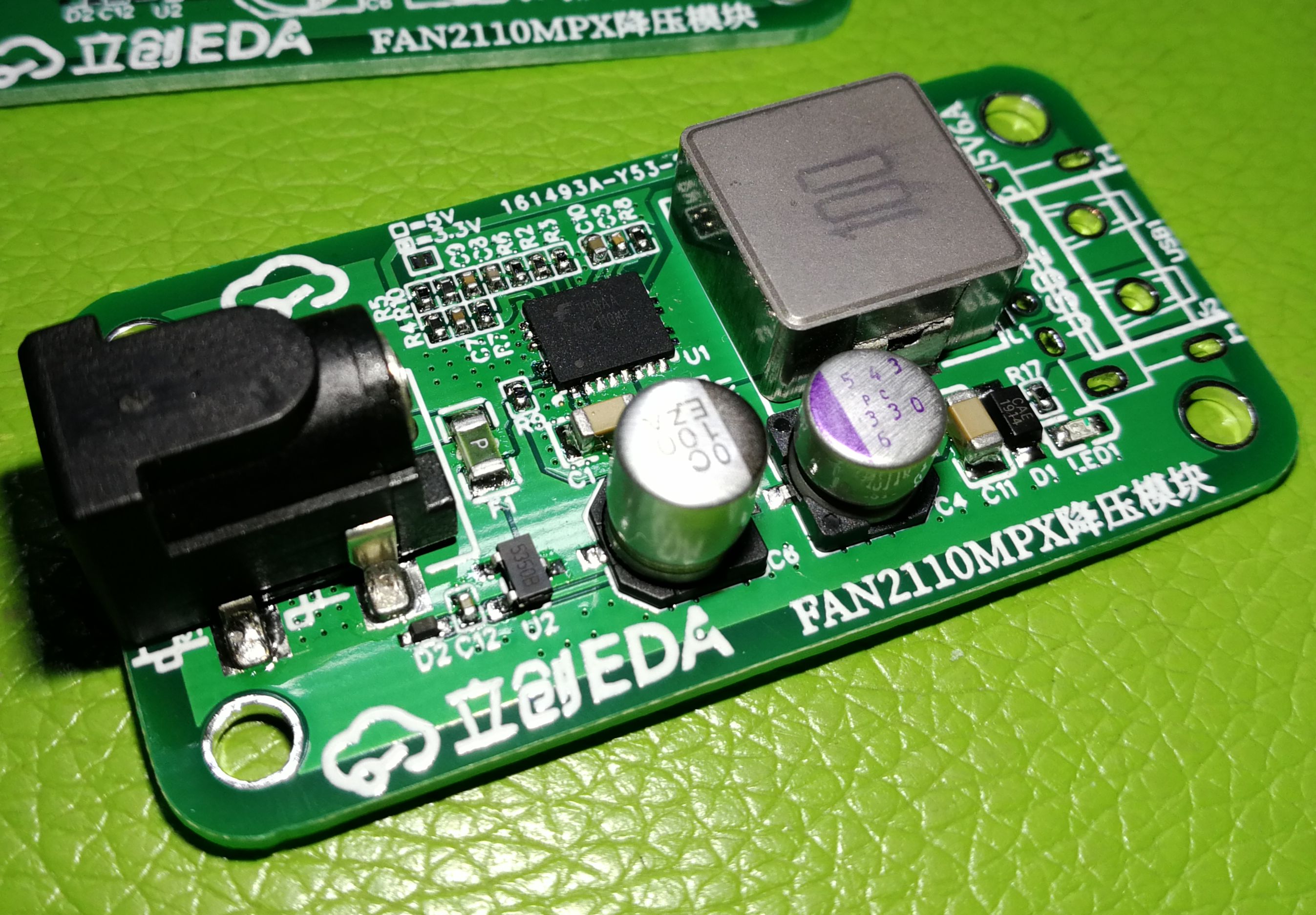

FAN2110MPX high current buck module
Chip solution DC-DC chip FAN2110MPX
A very compact high-power DCDC step-down chip can obtain high-power output of 3.3V10A/5V6A.
Suitable for use in products with limited space.
The module inputs DC socket 5-20V. Output binding post or USB socket. 3.3V10A or 5V6A. (The voltage dividing resistor needs to be modified, no external adjustable resistor is required) Fixed voltage output.
DC input voltage: 5-20v (test 20v)
Output voltage: fixed voltage default setting 5v, jumper short circuit 3.3v
Output current: 6A (maximum 10A lower voltage)
Quiescent current 21ma
Load test output efficiency:
1A (90.3%), 2A (93.1%), 3A (93.2%),
4A (92.5%), 5A (91.4%)
