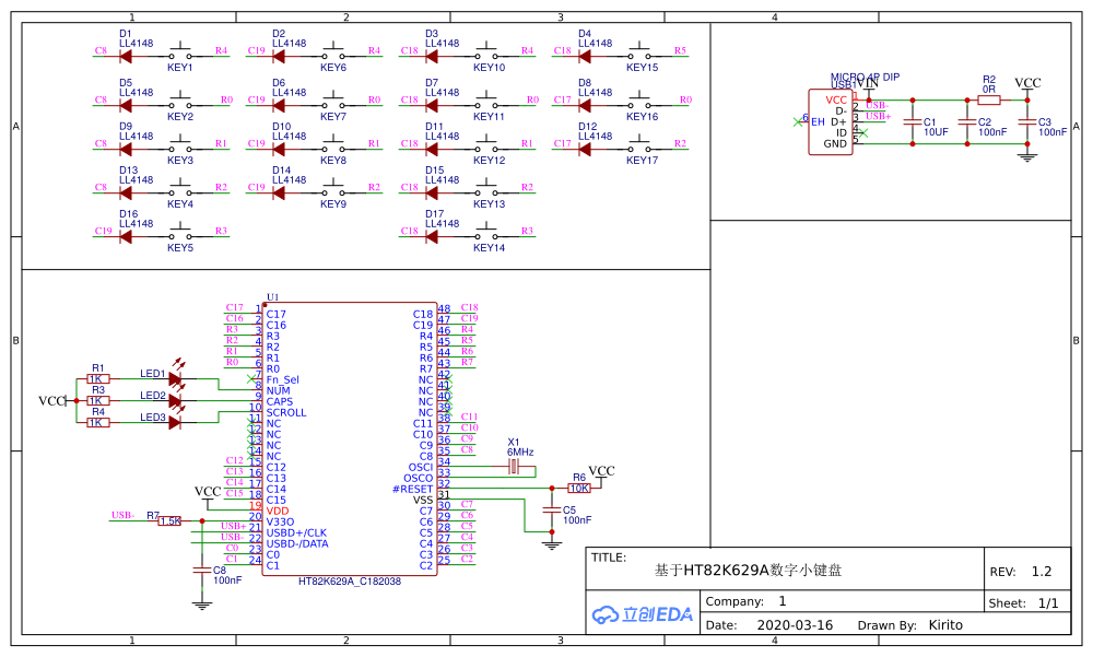

Original project link: https://oshwhub.com/Kirito/shuo-zi-xiao-jian-pan
This project is a numeric keypad without HUB function, used for 5 yuan proofing
