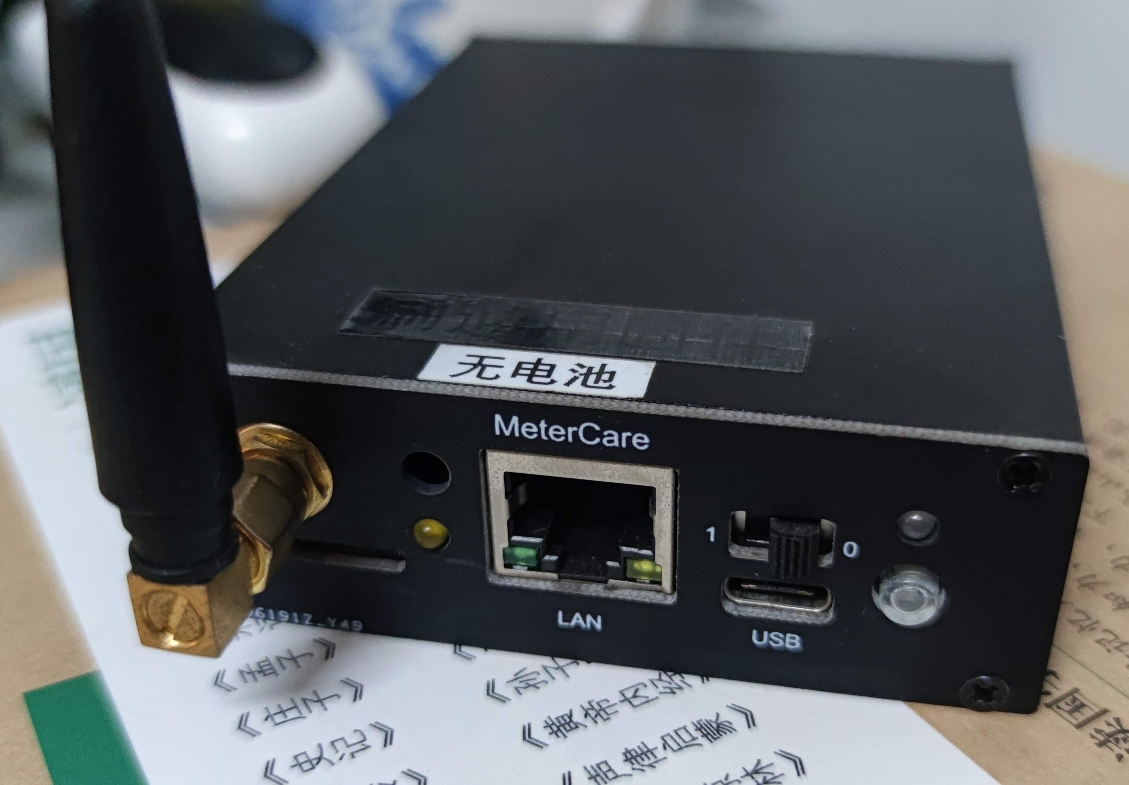

1. IoT expansion board for instrument GPIB, which can use GPIB, LXI, rs232 and instrument communication
2. Internet communication methods include WIFI, TCP/IP
3. USB connection to the computer-side host computer software can also be used for data analysis and instrument control.
4. Have operational capabilities such as VISA library functions
5. You can also use TF card to expand offline data collection
6. Due to limited board space, the RS232 interface is canceled and the trigger IN/OUT interface is added.

Physical map:
