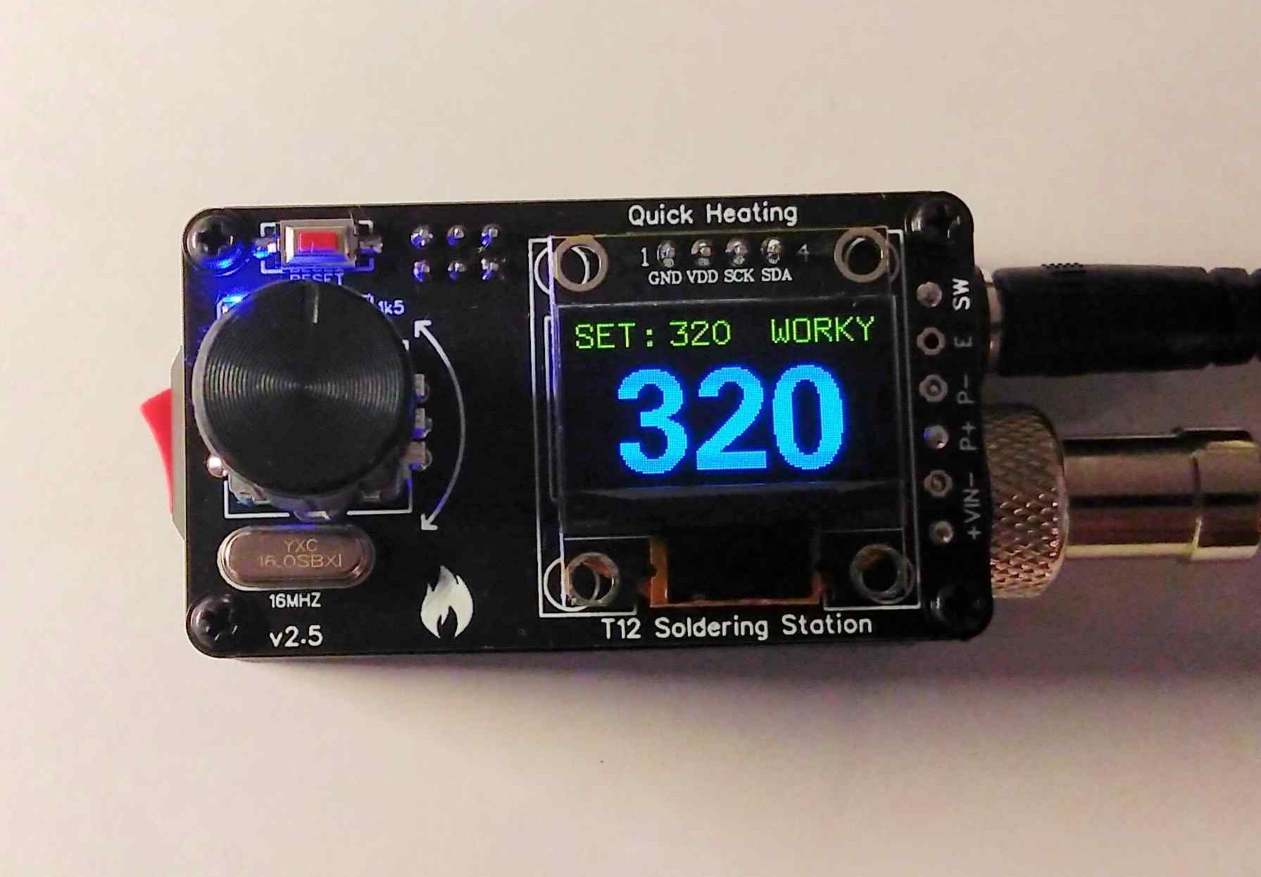

The T12 rapid heating soldering station features
  • Tip temperature measurement
  • Temperature control via rotary encoder
  • Short press the rotary encoder to switch boost mode
  • Long press the rotary encoder switch setting menu
  • Handle motion detection (by checking ball switch)
  • Iron not connected detection (by identifying invalid temperature readings)
  • Time driven sleep/off mode (motion detection) if iron is not in use
  • Measure input voltage, Vcc and internal temperature of ATmega
  • Information display on OLED
  • buzzer
  • Calibrate and manage different soldering tips
  • Store user settings to EEPROM

Notice
In board version 2.5, diode D1 may overheat. For safety reasons, the 18V zener diode D4 should be removed and the soldering station should be run at a maximum of 20V. Alternatively, diode D1 can be replaced with an SS54 Schottky diode, and BJT Q1 can be replaced with an FMMT619.
