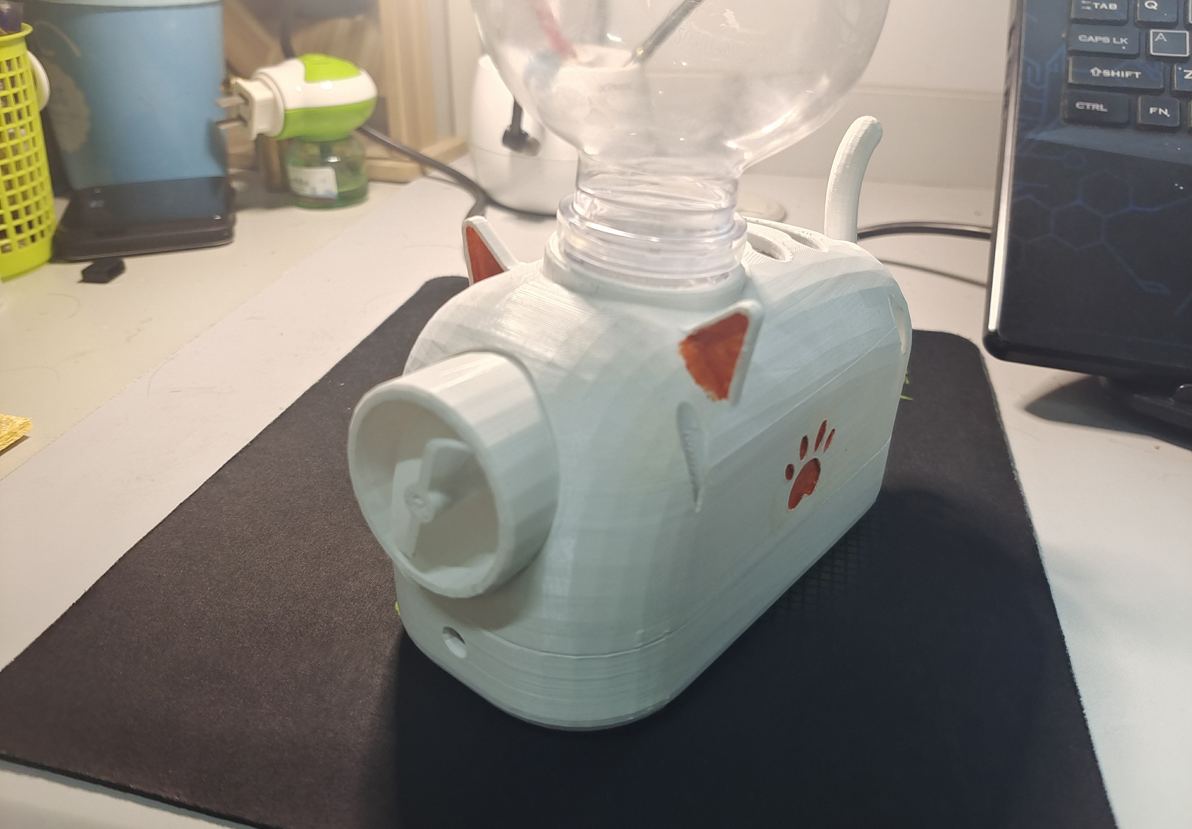

5. Structural model
The shell is designed in the shape of a cat. The feeder has four parts that need to be printed: upper shell, lower shell, push spiral tube, and conveyor sleeve. As for the grain storage bottle, it is a 900ml large tea bottle (the bottle mouth is large and the capacity is sufficient).
Printing material: PLA;
printing parameters: layer height 0.15mm, infill 50%, some structures need to be supported;
printing time: estimated to be about 34 hours; cat feeder.pngCat feeder.jpg

7. Physical display
