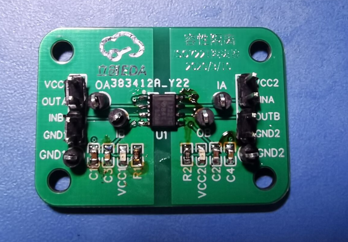

This project is used to verify the module design of the ISO7221CDR isolator chip of Lichuang Mall.
Known compatible models are as follows
Component model | |
ISO7221CDR | |
ISO7321CDR | |
ISO7221ADR |
For more compatible models, please refer to the relevant component manuals to determine.
The difference between ISO7**0 and ISO7**1
The input and output terminals of the two channels ending in 0 are on the same side, and the input and output terminals of the two channels ending in 1 are on opposite sides.
The channel layout of ISO7**0 is as follows
Enter A | OutputA |
Enter B | OutputB |
The channel layout of ISO7**1 is as follows
Enter A | OutputA |
OutputB | Enter B |
If there is any discrepancy, refer to the manual of the corresponding component.
Two isolated power supplies are provided on VCC1, GND1 and VCC2, GND2 on both sides. The voltage value is within the corresponding allowable voltage range of the chip. (For ISO7221CDR, this range is 2.8~5.5V)
Provide an input signal on the IN port, the signal frequency is no higher than the signal frequency, and connect an oscilloscope to the OUT port to observe the output waveform.
