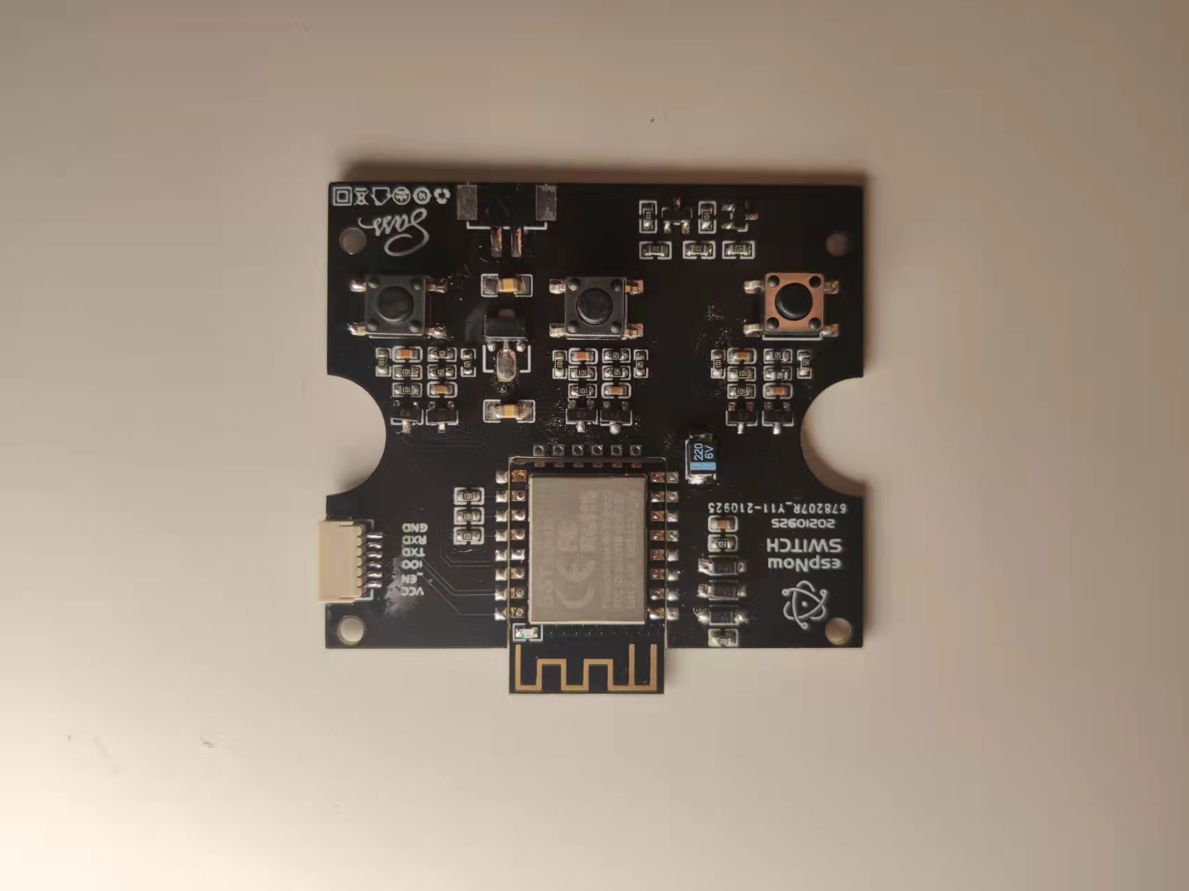

  • In terms of hardware, ESP8266 is used as the sending end of the ESP_NOW switch. When the switch is not pressed, ESP8266 is in a permanent sleep state. When the switch is pressed, it resets the chip and latches the pressed switch. After the chip starts, it reads You can determine which button was pressed by taking the port status, and at the same time send data through the ESP_NOW protocol. After the data is sent, it enters the sleep state again.
  • In terms of power consumption, it is about 20mA when transmitting and less than 5uA when sleeping. If it is not switched on and off very frequently, a 200mAH lithium battery is estimated to last for one year.

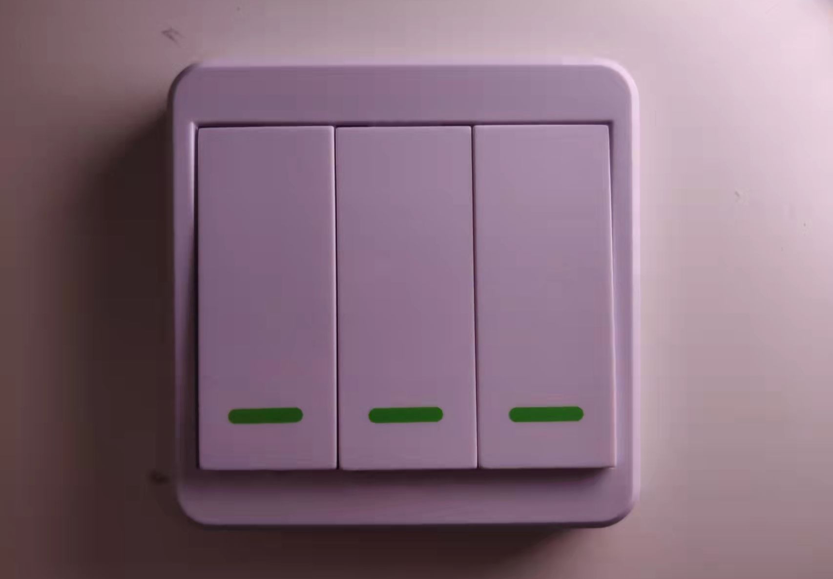

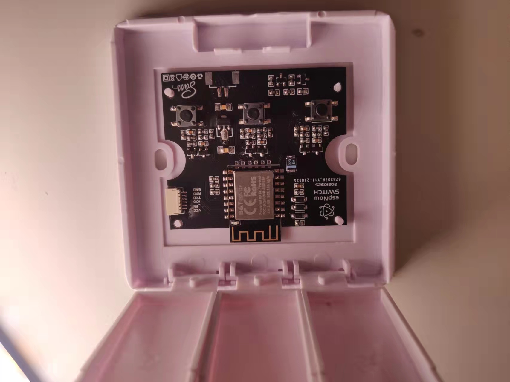

At present, the project has been tested, functions normally, and has been put into use. oaHa5R.jpg

Circuit explanation
The more innovative part of the circuit is the circuit that resets and latches the IO status at the same time. When the switch is pressed, RST can be reset and the corresponding port is pulled high. After the ESP8266 detects the port, the port level is pulled low. , release the latch state.

  • There is a problem with the packaging of HT7333 in the PCB! ! ! Remember to transfer here
