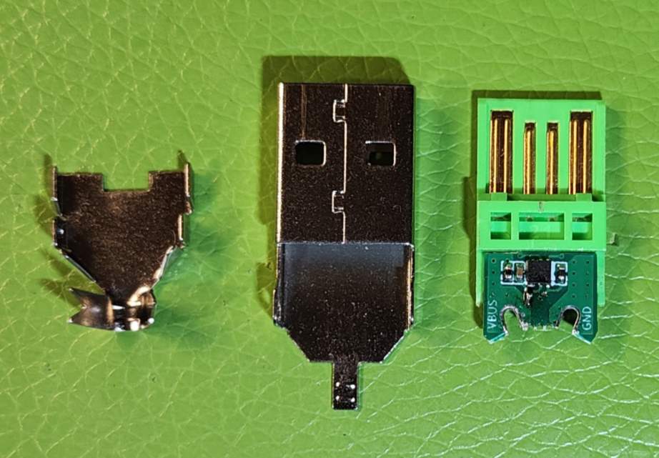

The built-in USBA male connector is convenient for making various decoy wires.
The deception voltage can be set freely:
This project includes 4 application methods:
(USBA male deception, C male deception, C female deception, C male EMark)
Solution features: cheap price, 6 gross chips.
Solution pitfalls: The QC protocol requires one of the CCs of the chip to be pulled up. There are two groups of AC lines on the market --- (one group pulls up 1 CC, and the other group pulls up 2 CC).
                  If you need to design it yourself, please pay attention.
