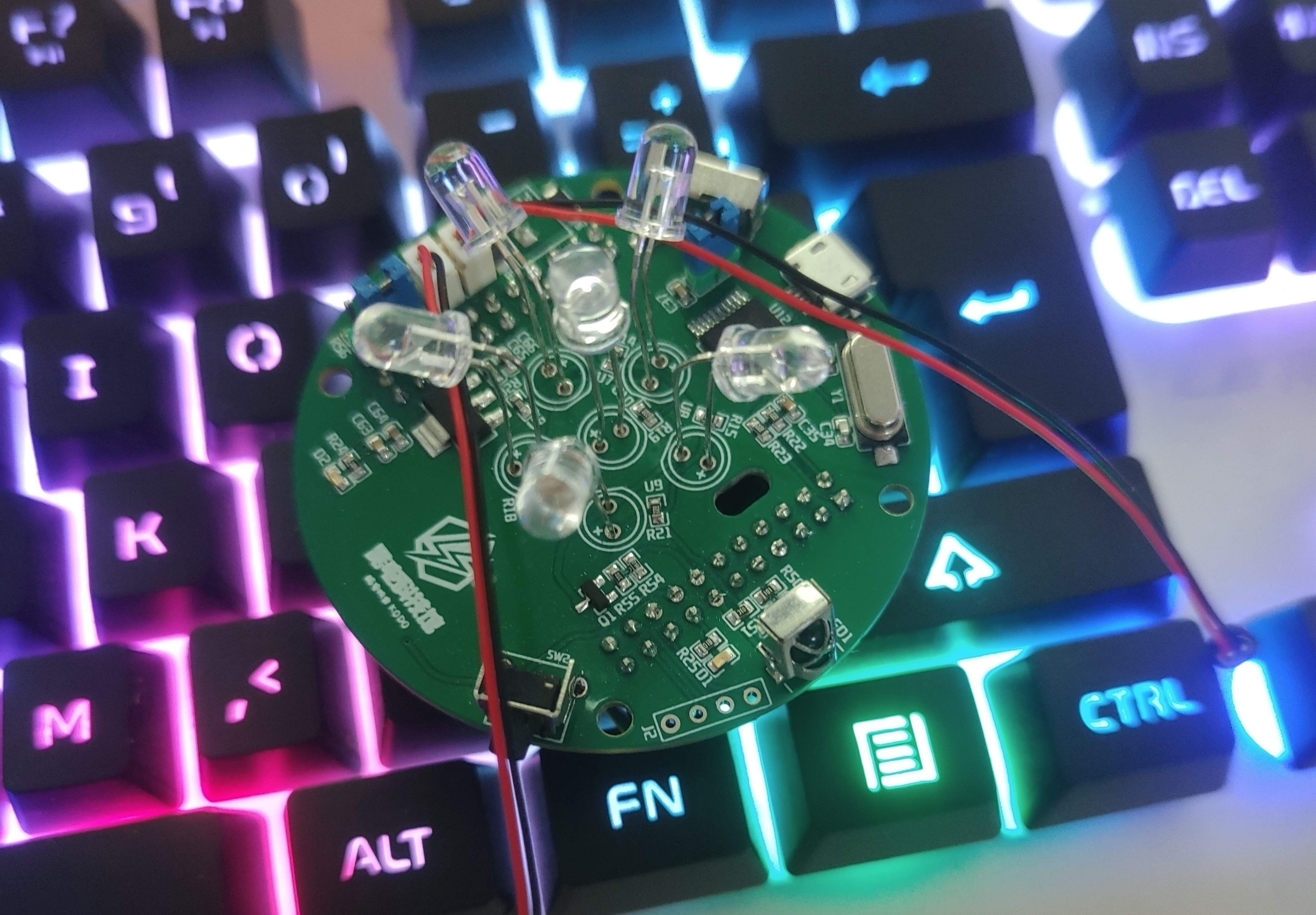

②Hardware design: This project is the hardware circuit of the main equipment, with the CI1103 speech recognition chip as the main control, the external ESP8266 WIFI module is used to build a local area network, and the infrared remote control circuit is used to control infrared home appliances. The slave device hardware circuit uses the CI1122 speech recognition chip as the main control, which can be used as an independent voice assistant. The additional ESP8266 module is used to connect to the master device and receive instructions from the master device. The infrared remote control circuit is used to control infrared home appliances.

1. The main device uses CI1103 speech recognition chip as the main control, and the offline voice core board and infrared remote control base board are discrete designs.
2. The slave device uses the CI1122 offline speech recognition chip as the main control, plus an infrared remote control circuit and a WIFI communication circuit.
