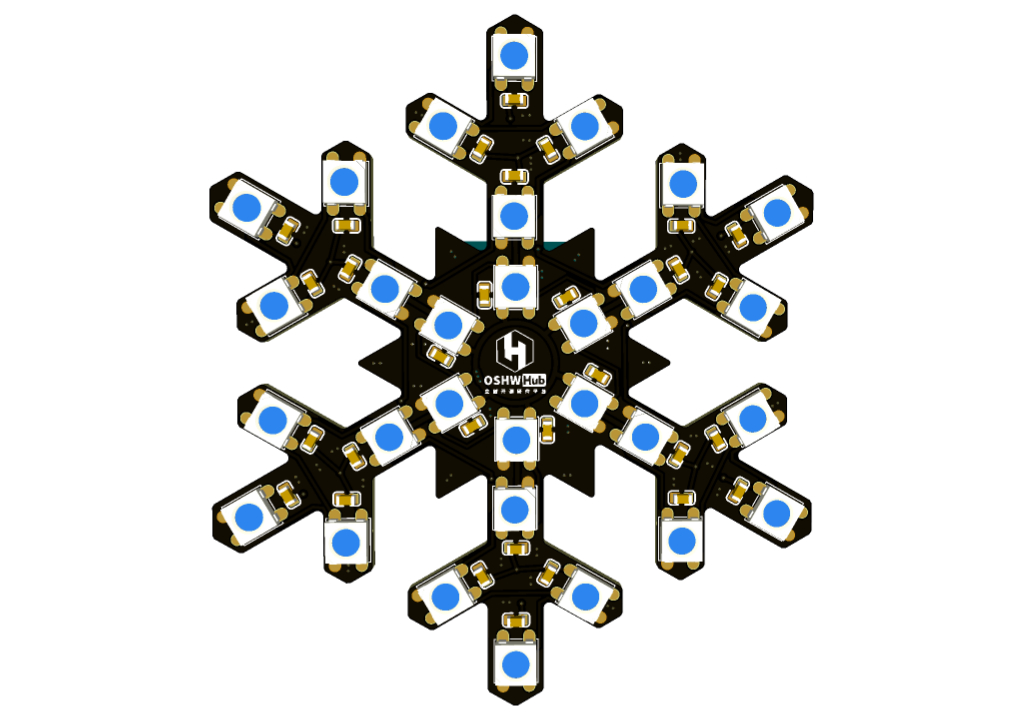

2. Function introduction:
①ESP-12S main control, based on Blinker IoT platform, realizes WIFI network control
②Mobile APP can realize 256 levels of brightness control and full-color color adjustment
③Tmall Elf voice control to realize partial color adjustment (Tmall Elf entry limit)
Front view:

3. Picture display and video demonstration:
1. Video link: Tmall Elf Sound Controlled Snow Lamp
2. The components are dense. If you have a constant temperature heating station, it is recommended to solder the capacitor. If you are afraid of damaging the lamp with manual welding, you may not solder the capacitor.
3. Manual welding, the lamp is not resistant to high temperatures. Be careful when welding. Don’t damage the lamp. If the welding time is too long and no video is recorded, just follow the silk screen welding process.
PCB and finished product pictures:
Front view:
Rear view:
