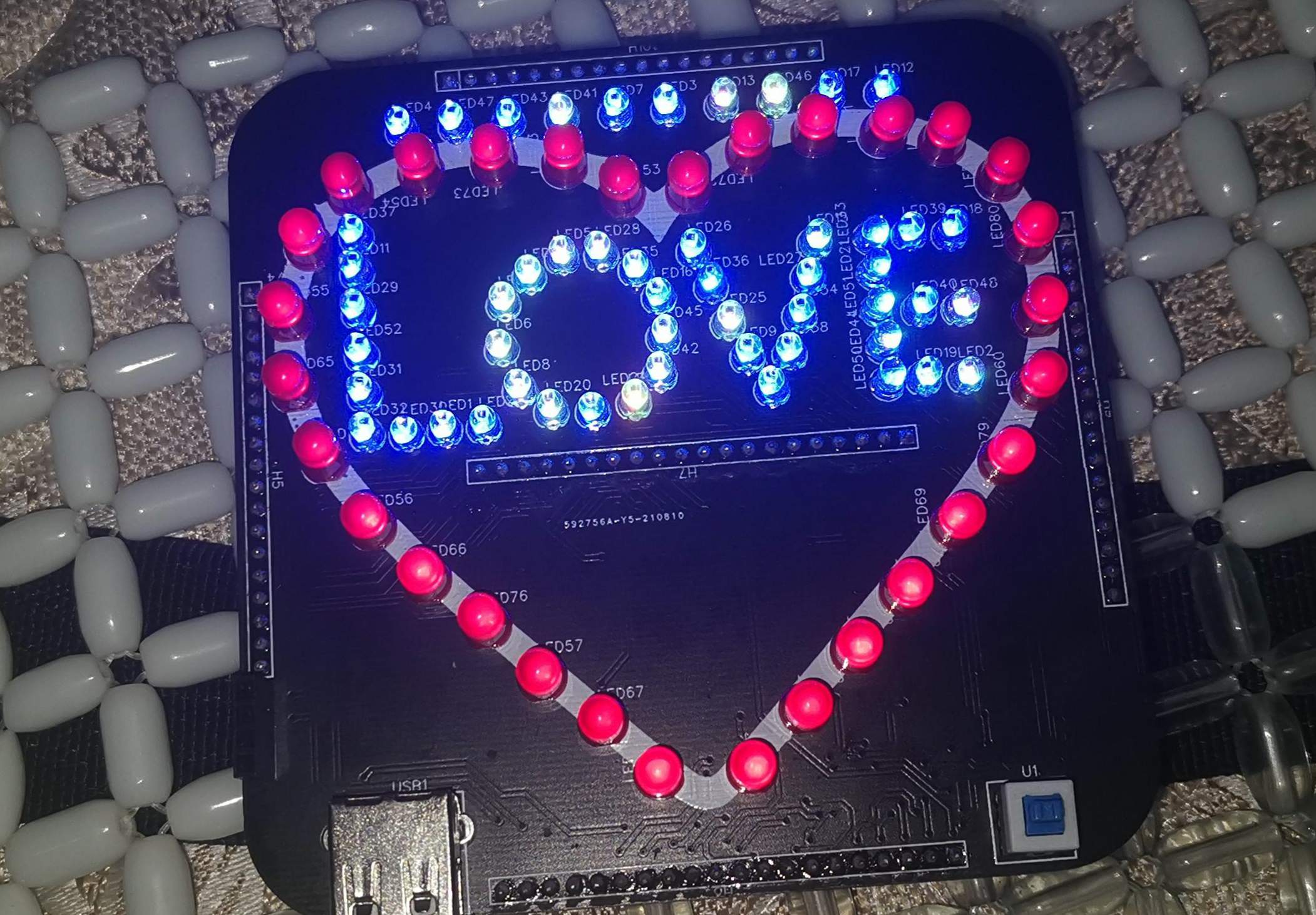

(1) This version actually has a lot of things that need to be modified.
1. The USB is a bit ugly at the top
2. The selection of the self-locking button is not very good, and the packaging is wrong. This kind of button is easier to break if pressed too much (the self-locking connection in the picture is reversed, and the required wires are connected at the bottom)
3. I forgot to omit the device number, which resulted in it being typed out when printing the board.
4. You can add some pictures on the PCB (the board size space is not properly utilized)
5. The power supply can be changed to a 3.7V lithium battery, and a boost is required (if you continue to use USB power supply, you can add filter capacitors and decoupling capacitors depending on the situation)
6. Regarding the download problem, you can change the straight female header into a curved female header, and change it from the top to the bottom.
7. Module addition: you can add a 0.96-inch OLED screen
8. The colorful LED is too bright, you need to add an adjustable resistor to change the brightness (10K is enough)
9. I am not very good at welding plates, and my welding skills are a bit poor (the last picture requires more practice!!!)
