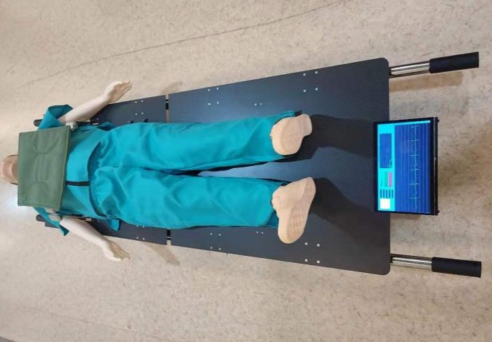

Machine front view
Figure 1 Intelligent chest compression and defibrillation integrated device
  This device is an integrated first aid device that does not require professional intervention . It integrates all the functions required for cardiac arrest first aid. Low risk, full functions, low cost, high intelligence, easy to use, easy to store and maintain . It can effectively solve the problems of high risk, cumbersome use, high cost, low intelligence and difficult maintenance of existing equipment .
  This equipment independently and innovatively designed an rescue equipment that integrates a foldable ambulance stretcher, automatic ECG monitor, automatic ECG analyzer, full-chest automatic chest compression machine, and biphasic defibrillator. A huge improvement in "1+1>2 " .
  The electric defibrillation circuit design of this device adopts a multi-isolation scheme . Compared with traditional non-isolated electric defibrillation circuits, it has the advantages of more stable operation and stronger anti-interference ability. At the same time, thanks to the adoption of a pure digital control scheme , it has the advantage of high control freedom.
  This device integrates electric defibrillation and chest compression in its mechanical structure, which can save more than 30 seconds of rescue time. This is of great significance in the golden 4 minutes.
  This device innovatively adopts the simultaneous transfer and full-function treatment solution, which is our first initiative. As shown in the animation 2 , it further improves the treatment efficiency.
Figure 2 Transfer compression
Animation 2 Simultaneous transport and treatment (double-click to play)
