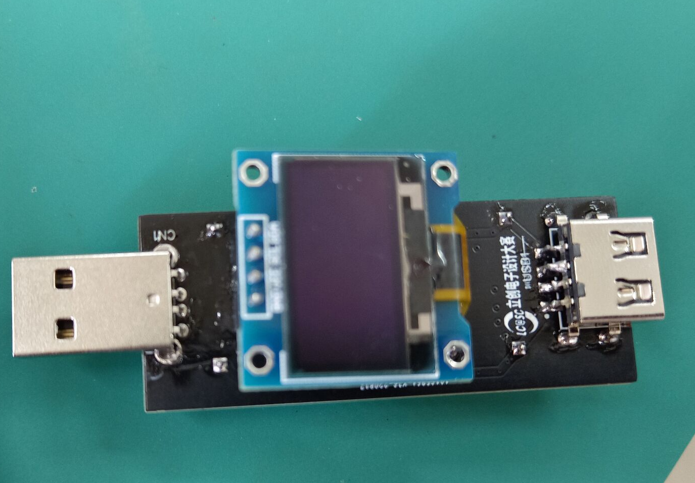

National Technology N32 MCU
USB Power Meter
Lichuang Summer Camp
Power Indicator
u9L3ZIQBjLYnZcaFsXZ0V8Dk2hAkfVe9vlgA9u3C.pngBmOO5E5hLfL1lrJpLcFPECnM0SIhTwVX0LYjyMWk.jpegThere are two LEDs, one 3.3V and one 5V
Voltage conversion
6LqUmuARbJdkZ4A5XTpbsyApBXlN7iHIX2fX1lWj.pngXC6220B331MR-G is used to step down the input 5V voltage to 3.3V to power the MCU and current detection chip Current
detection
INA199
Rv8D7xkfyEkuGmejK5N8a0Aeg5g9y0iSJaGnfyVp.pngwatermark,type_ZmFuZ3poZW5naGVpdGk,shadow_10,text_aHR0cHM6Ly9ibG9nLmNzZG4ubmV0L3hpbnhpYW9jaQ==,size_16,color_FFFFFF,t_70watermark,type_ZmFuZ3poZW5naGVpdGk,shadow_10,text_aHR0cHM6Ly9ibG9nLmNzZG4ubmV0L3hpbnhpYW9jaQ==,size_16,color_FFFFFF,t_70Voltage detection
Simple resistor voltage division
It must be noted that the voltage must be less than 3.3V (VADC)
mmjK5qAZAYuCiezLBeqp5gdHBzoKlSIsT6Kuad17.pngThe extended UART port can be used to transmit data
There is a 0Ω resistor in the schematic diagram to isolate GND.
