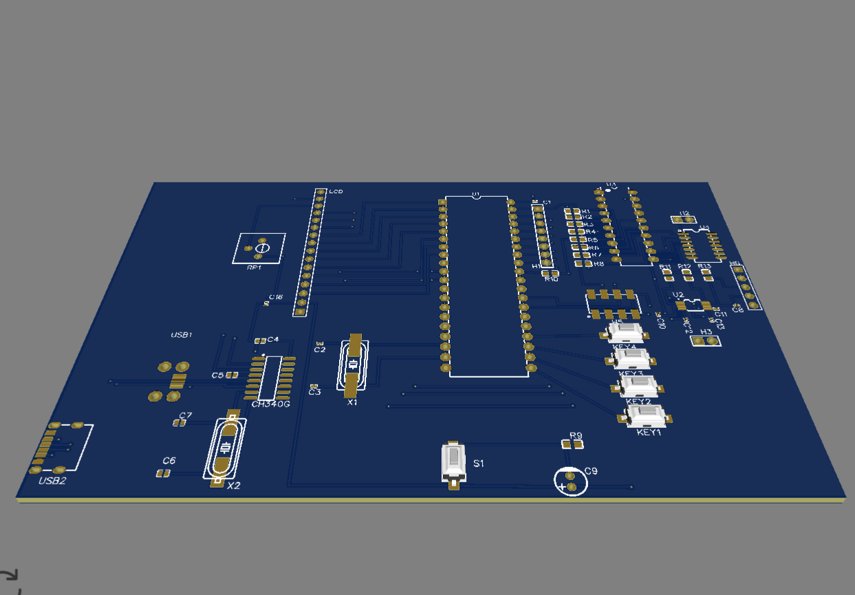

AD转换电路使用ADS1115转换器。ADS1115包含输入多路复用器(MUX),可以测量四个单端或两路差分信号。这里使用AIN0和AIN1单端输入,电路板中留一个2p的排针,用来接入量程为5V的交变电源,最后检测得的电压值应为VAIN0-VAIN1。在检测电压读值的准确性时利用开关控制电路转为用DA模块产生电压,输入AIN0和AIN1。将AIN2和AIN3连接0.1μF电容并接地,SCL和SDA为输出端。引脚功能如图:

5. Circuit diagram and PCB

Simulation circuit diagram (including AT89C51, independent buttons, AD module, DA module, LCD1602, crystal oscillator circuit):  image.png
Since Keil does not have the simulation component ADS1115 chip, it uses another ADS1015 chip with similar functions instead. The functions of the two chips are basically the same, except for some default register settings, so it does not affect the implementation of the experimental functions.
Test Results:
Through division of labor, our team is responsible for different modules such as programming and simulation. The functions finally implemented in our simulation results are: memoryless mode and memory mode of ADS1015, and the detection circuit of DAC0832.
The simulation results this time did not reach the initial expected results. Unfortunately, the accuracy of the voltage value collected by ADS1015 was not well controlled. There is a large gap between the output voltage value and the real voltage value. We will continue to review the data and rewrite it. Code and schematics to try to solve this problem.
