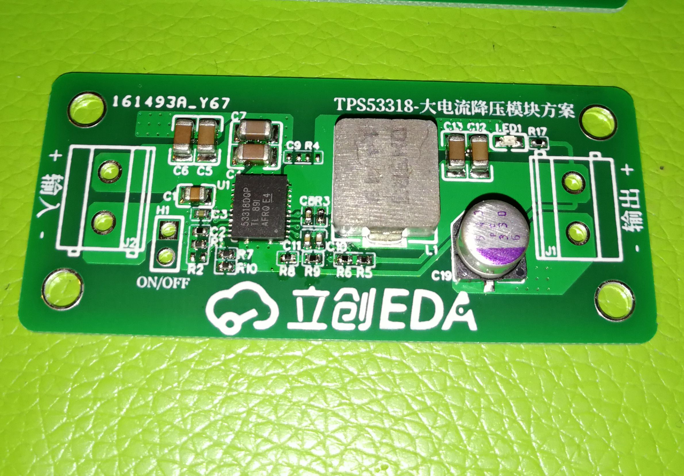

Chip solution TPS53318DQPR
The input and output of this solution board are in terminal mode.
Input voltage: 1.5-22V (default 12V)
Output voltage: 0.6-5.5V (set output 5.1V)
Output current: MAX 8A (actually controlled within 6A) to enhance heat dissipation
Switching frequency: 500KHz
Quiescent current 2ma
Load test output efficiency:
1A (92.7%), 2A (95%), 3A (95.2%),
4A (94.7%), 4.9A (94.1%)
