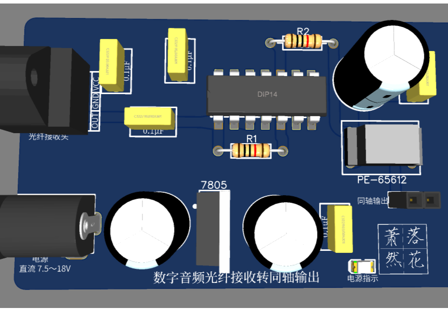

Fiber to coaxial
Simple fiber optic receive to coaxial output.
Use 74HC04 for shaping, with digital output transformer.
The accessory shell is for reference, the opening is not drawn, it is the shell left over from the original project.
