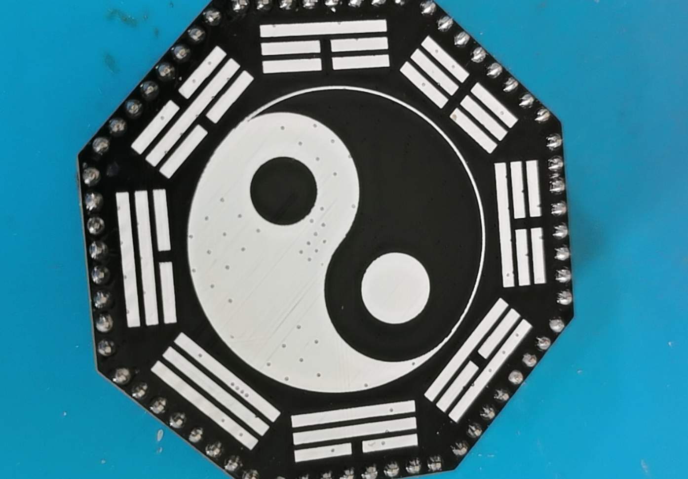

STC32G12K128 Taichi
Use AD to draw, there may be problems when importing lceda. If you have gerber as an accessory, you can directly create the board
r1 as a jumper. Select whether vref is linked to vcc. Do not connect the vref r2 jumper from the pin header
. Select whether to connect the ucap
r4 jumper. At that time, I was afraid of insufficient power supply. I wanted to pass through both sides, but there were loops on both sides, so I added a resistor.
