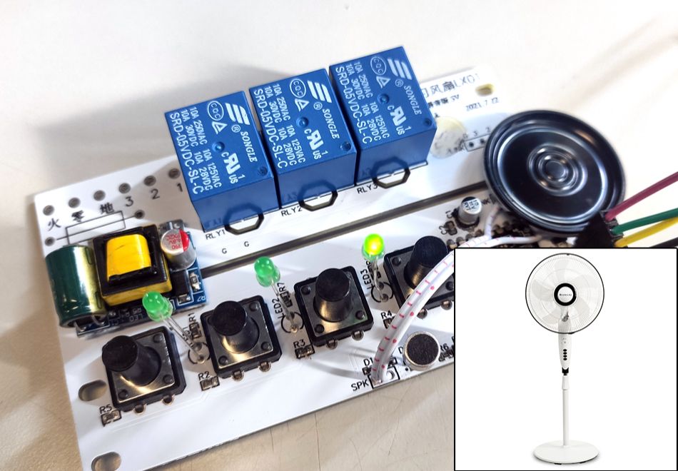

* 1. Introduction to project functions
Liangxi smart fan LX02 based on Qiyingtailun offline voice module CI-C22GS02S can transform the old fan at home without moving your hands.
        • Through voice recognition technology, you can turn on and off and control gears by just moving your mouth without being connected to the Internet.
        • At the same time, it also retains the physical buttons, which can perfectly transform the old fan at home.
        • There is a plug-in LED light under the button, which can be adjusted according to the height of the original button.
        • The 3 gears have lights corresponding to each other, making it easy to identify the current gear;
        • It is worth mentioning that by properly selecting the LED current-limiting resistor, the LED light will not be dazzling at night and your sleep will not be affected.

4.1, 3 relay IOs
The PWM3PWM4PWM5 of the module is used as the relay control terminal (RLY_C1, 2, 3). Remember to lead out the MCLK pin here in the main control. This is necessary for the burning program.
4.2, 4 button IO
The module CI-C22GS02S ( C2759836 ) originally does not have many IO ports and only has two serial ports. This project does not use the serial port when it is actually running. Therefore, I want to use it as a button IO. I found it feasible by querying its manual: module CI-C22GS02S.
Pin number Pin name I/O type IO drive capability IO power-on default state Function definition
6 RX0  IO,T+U 4mA IN,T+U 1.UART0_RX 2.GPIO1_7
7 TX0 IO,T+U 4mA IN,T+U 1.UART0_TX 2.GPIO2_0
10 TX1 IO,T+U 4mA IN,T+U 1.UART1_TX 2.I2C0_SCL 3.GPIO3_0
11 RX1 IO,T+U 4mA IN,T+U 1.UART1_RX 2.I2C0_SDA 3.GPIO3_1
The pins of serial port 0 and serial port 1 both support the functions of ordinary IO ports, so they can be used to detect key input. Use TX1 as the 0th gear switch button on the pin, RX1 as the 1st gear switch, TX0 as the 2nd gear switch, and RX as the 3rd gear switch.
4.3. Relay drive
NUD3105 ( C14894 ) is used as the relay driver. This driver chip comes with MOS, current limiting resistor, reverse diode, etc., which can drive the relay well without affecting the MCU, greatly saving multiple components. It is very suitable for our DIY players who make handmade boards.
4.4. PCB partition
Since the fan casing is very small, if the buttons and relays are on top of each other, the casing will not fit, so we have to divide the board into two parts. After getting the board, cut the two pieces and connect them with flying wires. This will better fit the fan casing.
Cut along the dotted line
basically completed
cut board
