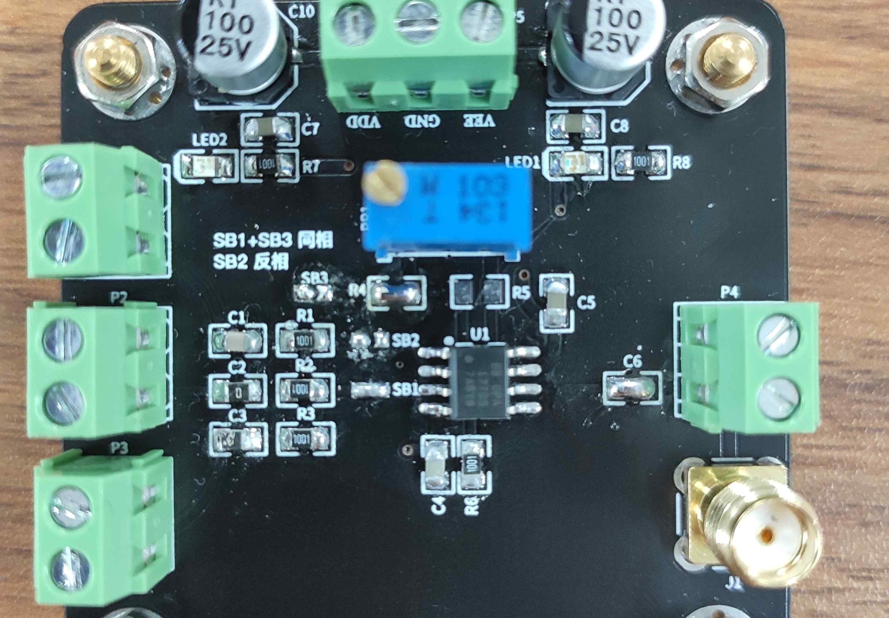

three-way adder
This three-way adder uses OPA177 as the operational amplifier, and is designed as a standard three-way in-phase and inverting adder. Short soldering SB2, SB1, and SB3 can be used to switch between in-phase and in-phase. At the same time, the amplification factor can be adjusted by adjusting RP1.
Physical picture: IMG_20191223_172341.jpgIMG_20191223_145106.jpgTest results: sine wave plus DC bias:
