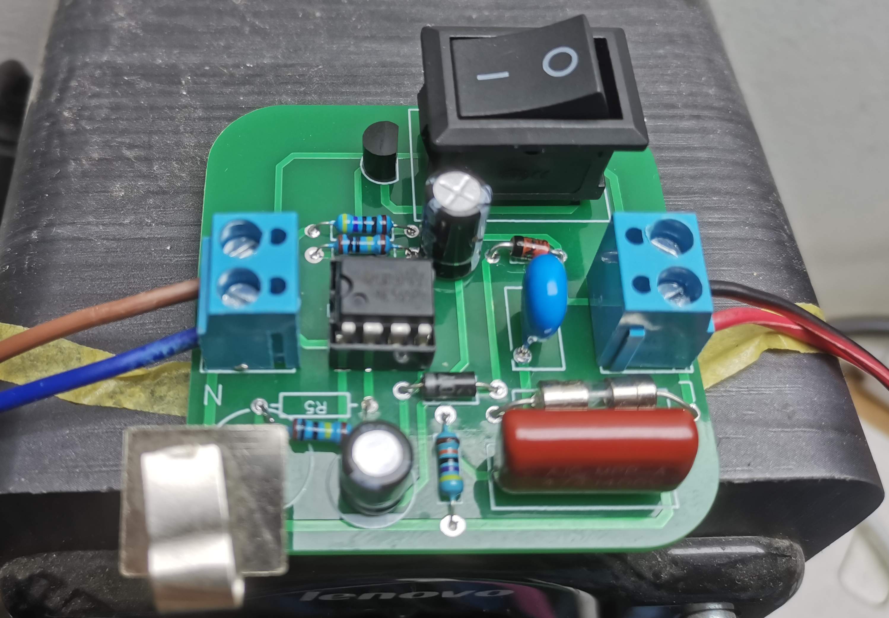

          When the delay switch is not used, simply press the boat-shaped switch to control the off and on of electrical appliances. The circuit changes when using a delay switch as follows.
          When the 220V AC power is connected, a DC voltage of about 12V is obtained at both ends of C2, which serves as an energy storage capacitor to power the 555 time base IC. When the IC is in a steady state, pin 3 is low level, and the triac is G-rated Low level, so it is turned off, and the electrical appliances are turned off. When you touch the touch spring (or other metal part) with your hand, the negative half cycle of the clutter signal induced by the human body is transmitted to pin 2 of the IC through R2, triggering the IC to flip into a transient state, and pin 3 becomes high level to trigger a bidirectional Silicon control, electrical power supply conduction. At this time, it enters the delay state, and capacitor C3 begins to charge through R1. When the level of pin 6 rises to 2/3VCC, the transient state ends, the IC flips to a steady state, and pin 3 becomes low level, causing the thyristor to turn off. Outage, electrical appliances are out of power. Each touch delays approximately 150 seconds.

Finished product
