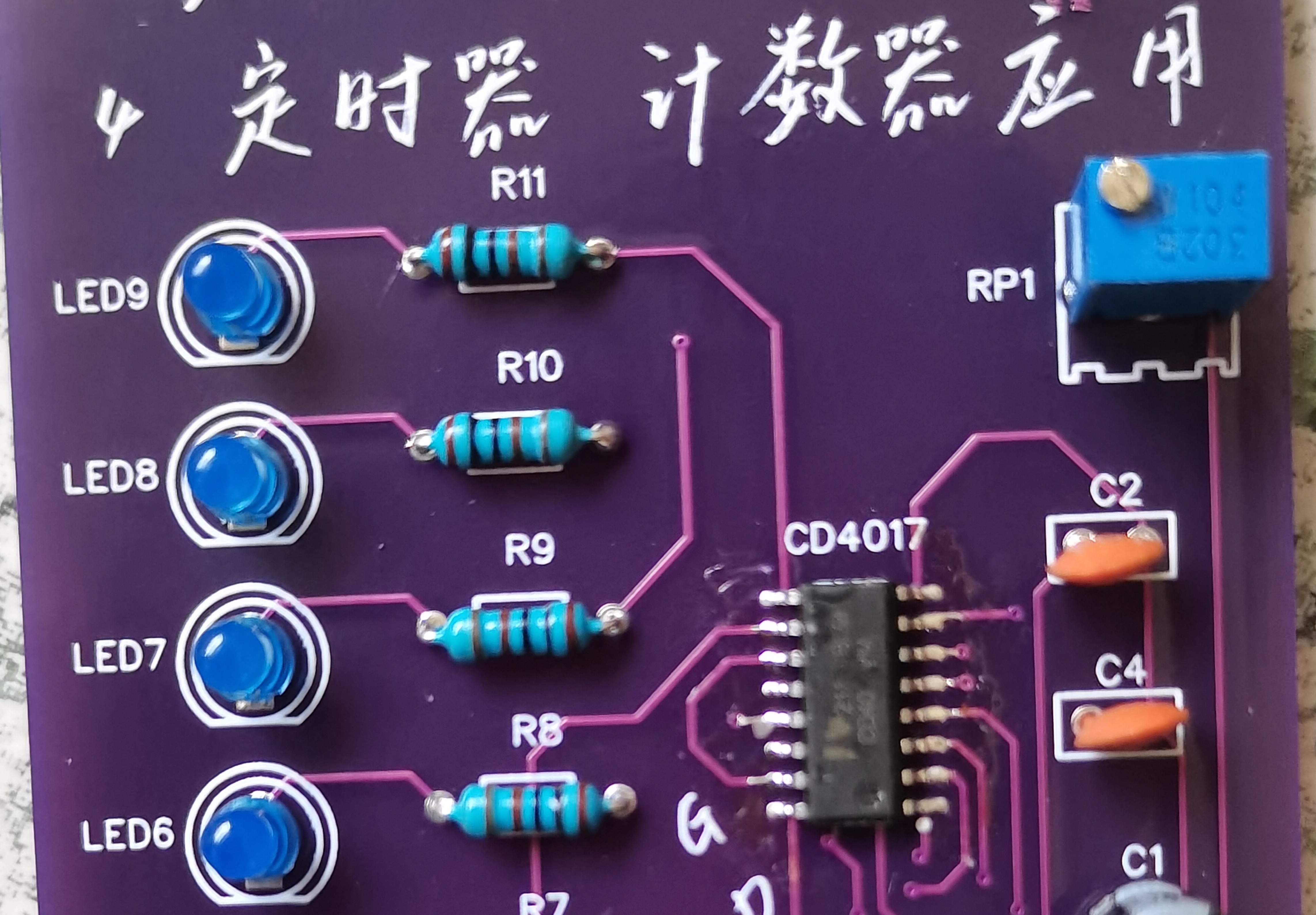

This nine-way water lamp controller can control 9 lamps to cycle and emit light, and the water flow speed can be adjusted. After power on, NE555 and peripheral circuits form a multivibrator. The oscillation frequency is mainly determined by R1, R2, W and C3. Adjusting W can change the oscillation frequency. The oscillation signal of the oscillator is output from pin 3 of NE555 and sent to the counting input terminal (pin 14) of CD4017. Every time a pulse comes, the high level of the counter's 00-9 output moves 1 bit in turn, lighting up the corresponding light-emitting diode, thus creating a feeling of running water. Q9 is connected to the reset terminal and plays an automatic reset role, that is, after the count is full, it starts counting from the beginning, so that the circuit continues to cycle.

Schematic Design Instructions
