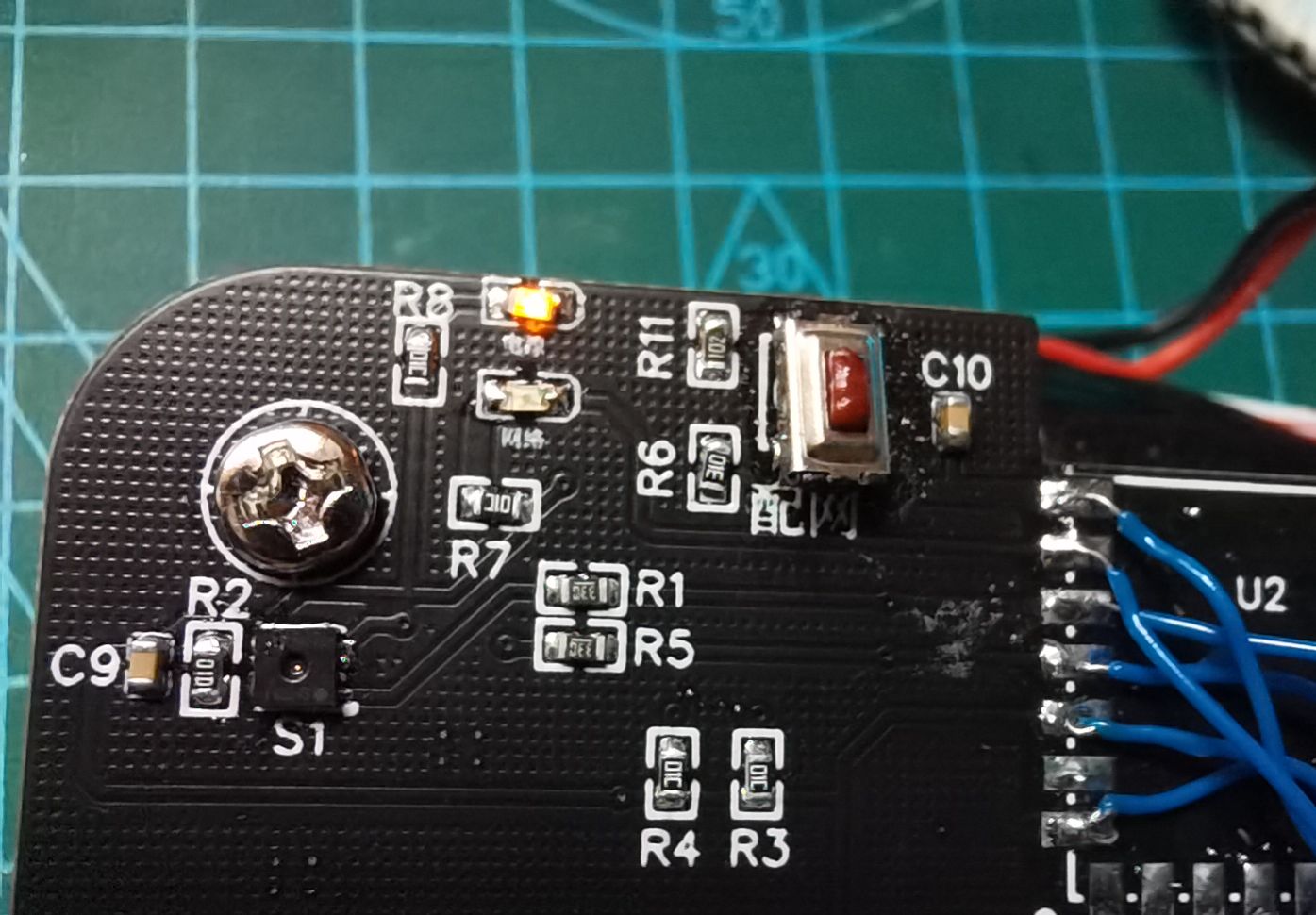

First of all, in order to save power consumption, I omitted the LDO and directly used the battery to power the module. The voltage of the disposable lithium battery is exactly 3.6v, which is within the voltage range of the module, so there is no need for LDO voltage stabilization at all.
But considering that some places are powered by power, I added a micro usb interface and provided a 3.6v output LDO
First, add an energy storage filter to the external power supply, and then use the anti-backflow diode
Next, consider how to switch between battery and external power supply. A CDSN blog gave me a DEMO as shown in the picture.
The following circuit diagram can be drawn according to the official DEMO.

Then!!!Attention!!!You need to configure the firmware
Select the corresponding pins for these two. Remember, if you choose the wrong one, it will be overturned. When the time comes, connect it with flying wires. Don’t ask me why my actual picture shows a module with flying wires.gIzFL39ZF1Uc4r31KjLORnKzAYGq45RMM1At1X1U.png

Actual pictures provided
After connecting, the mobile APP page
