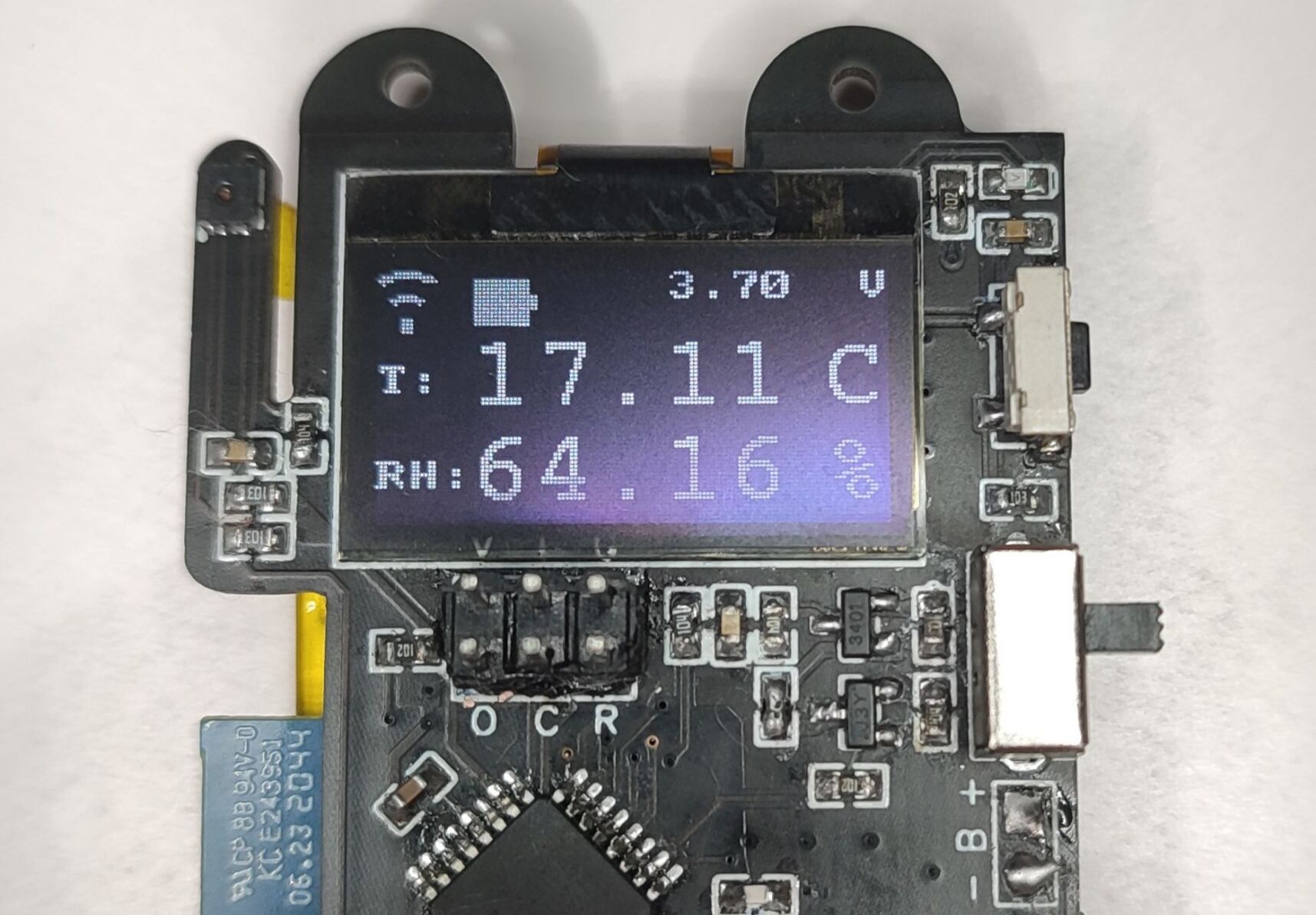

       It uses a 0.96" 12864 monochrome OLED, which is enough to display device information.
Temperature and humidity are refreshed        every 10 seconds , and battery power is detected every 30 seconds .
       When both WiFi and Tuya Cloud are connected, the WiFi icon will be displayed. If not connected, an X will be displayed.
       When the battery power is above 30% , the battery icon is a full solid icon.
       When the battery power is below 30% , the battery icon is a hollow icon for low power. And the fully charged icon flashes alternately every 1 second .

OLED screen viewing:
Physical PCB diagram:
