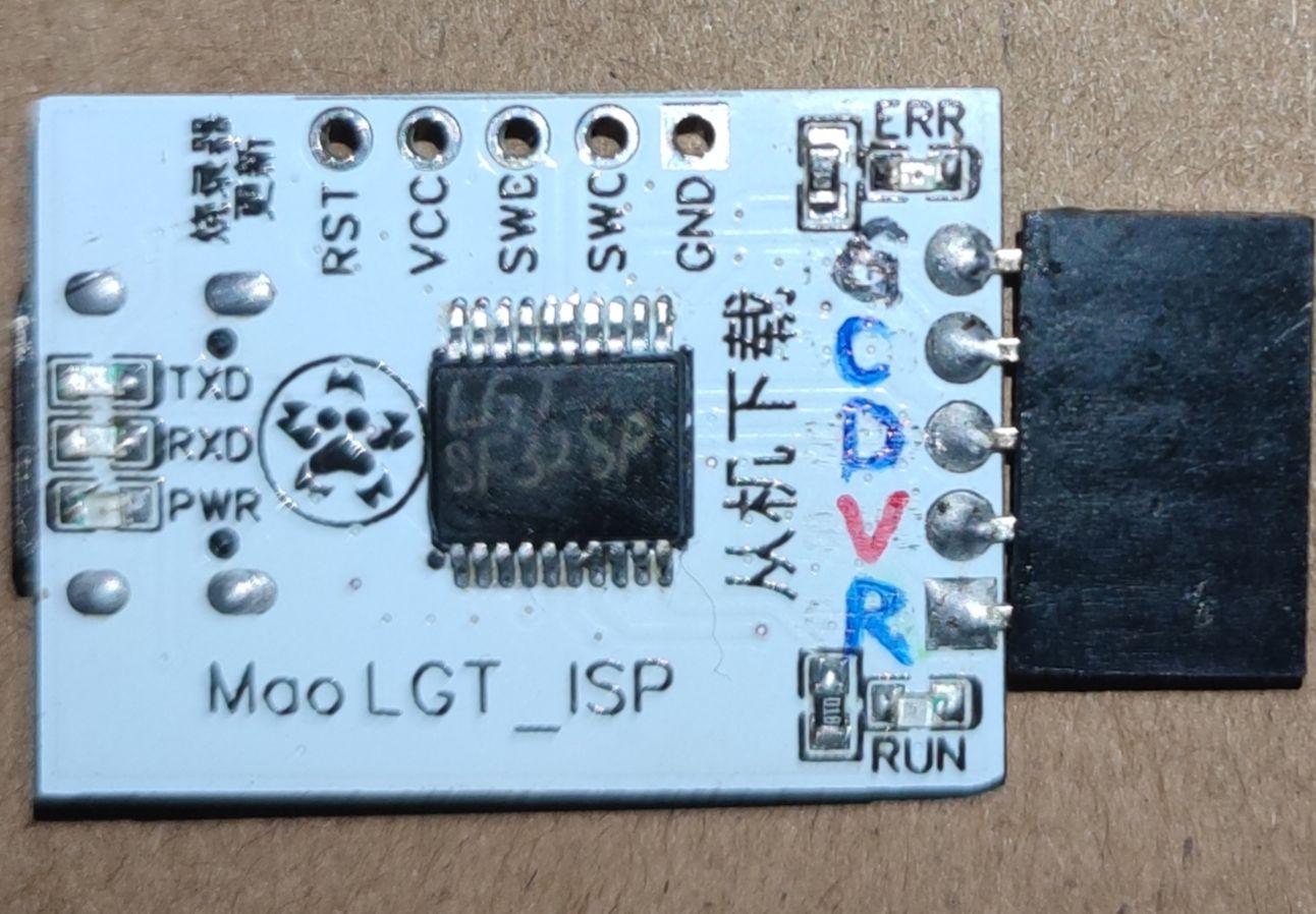

ISP programmer suitable for LGT chips
The LGT8F328P SSOP20 chip is used as a relay to convert ISP data into SWD data to program the LGT chip .
The external crystal oscillator and its supporting components do not need to be welded and do not affect use.
If you feel that the speed is too slow, you can enable the external crystal oscillator in the program yourself.
It can be directly connected to the MaoLarduino series development board , eliminating the need for DuPont wire and other wire connections, thus reducing the probability of programming failure caused by poor contact .
Programmer burning program one-stop nanny-style tutorial is easy to complete. The required programs and visual BOM (click here to download directly) have been packaged and uploaded to the project attachment, and you can pick them up if you need them.

Physical picture:
