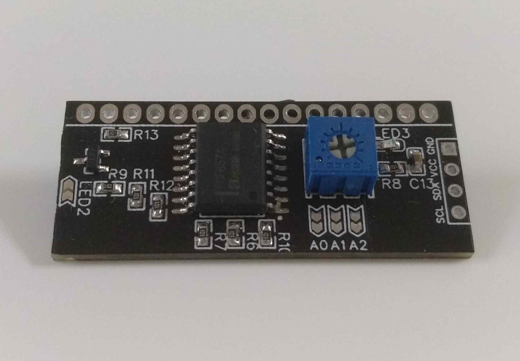

Project Description
This project is an I2C control board verification module based on HGSEMI (Huaguan) PCF8574T port expansion chip. The main purpose is to save the shortcoming that the LCD takes up a lot of IO when used. It only requires 2 power lines and 2 data lines, and cooperates with the function library You can communicate! Save the io for other uses, and my mother will no longer have to worry about not having enough io.

How to use (Arduino)
wiring
I2C control module Arduino
SCl A5
SDA A4
VCC 5V
GND GND

The default I2C address is 0x27 because none of the three jumper pads are shorted (1 = shorted)
