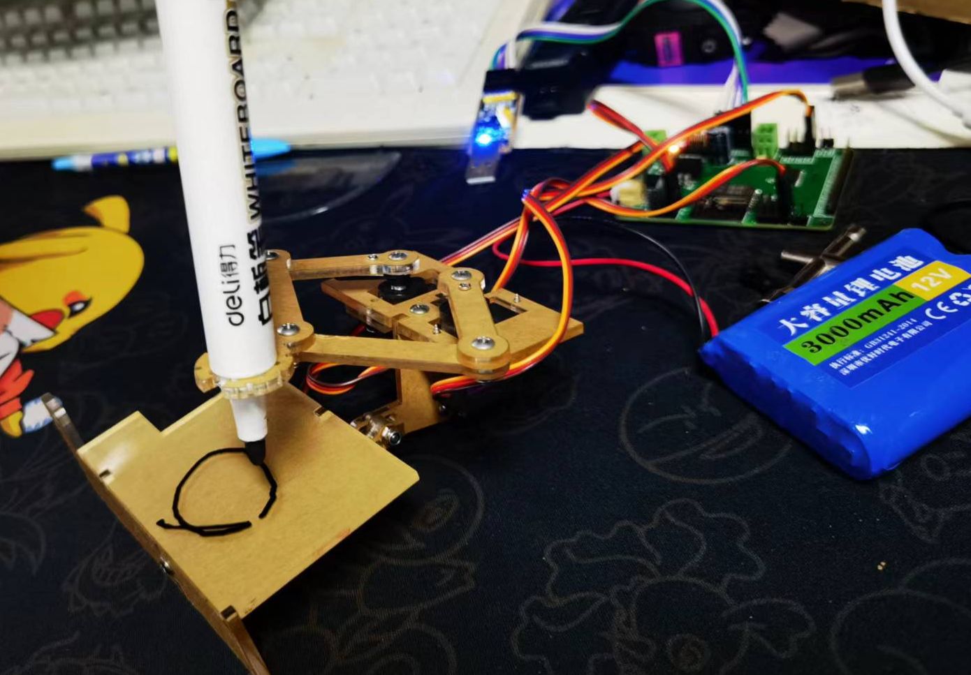

Introduction: Writing robot (plotclock) using the OpenHarmony system
Product introduction: It is developed based on the OpenHarmony open source Hongmeng system. The chip used is hi3861, which supports 16-channel servo control, GPIO, ADC, PWM and other operations.
Common operations such as writing and drawing graphics have been implemented
Chip solution: multi-channel steering gear control board based on HiSilicon Hi3861 chip and PCA9685
Product core parameters:
Working voltage: 7.4V~20V with overheating and overcurrent protection
Hardware interface: gpio, ADC, PWM
Double-layer board design single-sided layout
3 servos (mg90s metal gear 180°, Xubao 7.2 yuan each) Recommended metal gear, durable
Small clock structure: 3mm acrylic cutting version (cost about 15 yuan)

2.0 firmware can automatically write the time.
