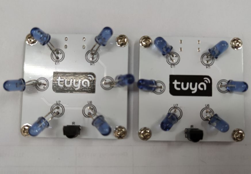

0.   Actual picturesInfrared 1
1. The air conditioner companion SOC solution is used , but only the universal remote control part is used.
