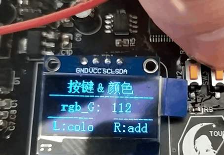

2>Button function:
u8 xKeyScan (u8 mode): Simple pull-up detection low-level design. The left button switches the setting color, and there are buttons to increase the color value, see the renderings 4 and 5.

      Figure 4: Switching the adjusted color
                            Figure 5: Increase the selection color value (*note1)
Precautions:
        *note1: Recording the reflection of the mobile phone causes the LED1 on the right side of Figure 5 to always record white (it is truly colorful to the naked eye). For the reason of recording, please watch the color of the reflection of the finger change with the numerical value.
