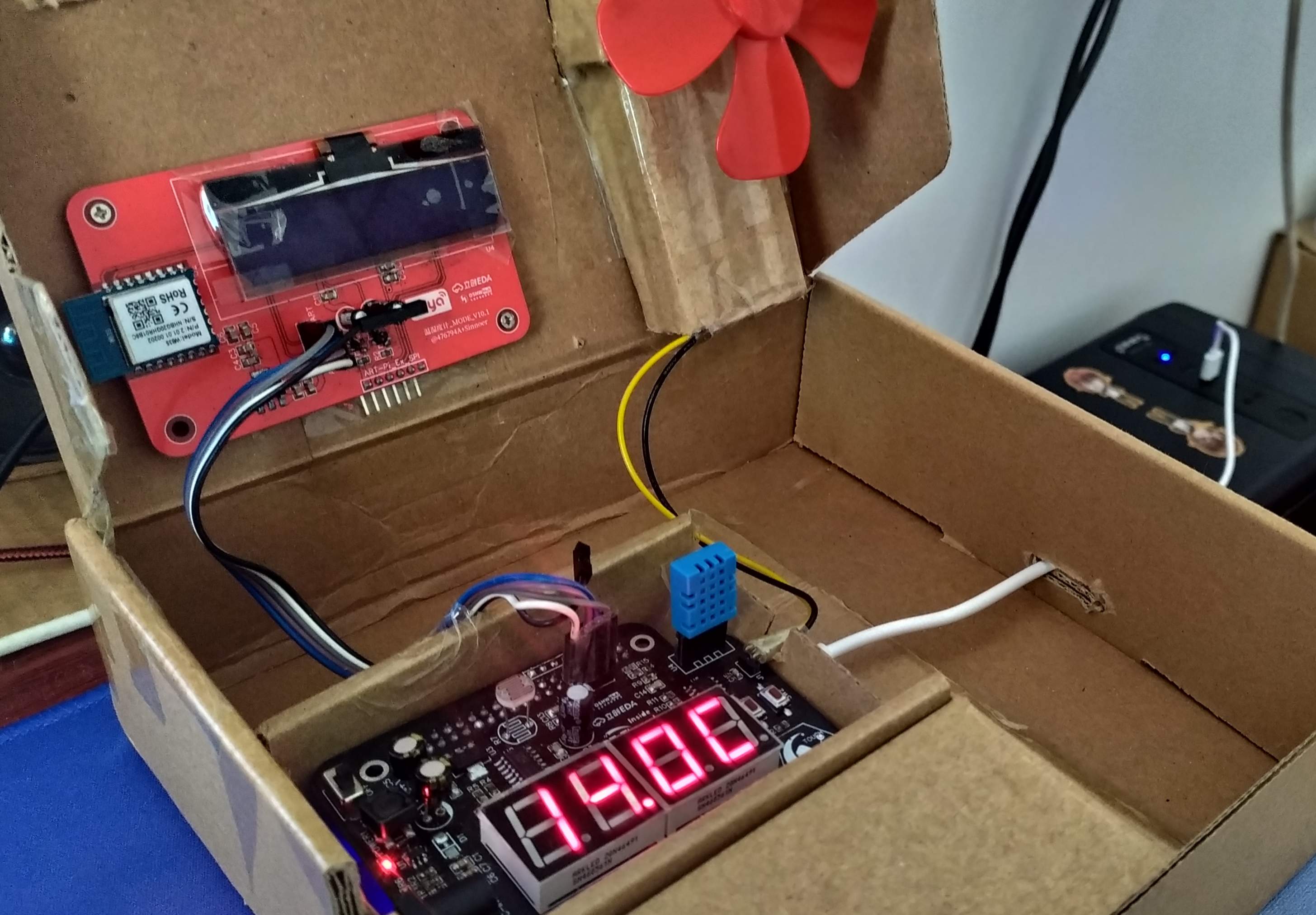

Figure 1: tuya&lc+ temperature and humidity sensor

  2.Hardware design
a, [MainCtrl_ART-Pi_SCH] has a DHT11 temperature and humidity sensor onboard. It is installed on the board in a direct plug-in form, and there is a fan interface to facilitate the adjustment of ambient temperature and humidity.
--DC12V power conversion; four digital tubes; TPAD touch buttons; photoresistor and two ordinary buttons. Data transfer[USART1]
b, [tuyaMode_SCH] +5V to +3.3V power supply; Tuya WB3S module; 2.23'' OLED reserved.

Figure 2: One-click dehumidification and cooling
Figure 3: One-click dehumidification and cooling via APP
Figure 4: Light sensor automatically adjusts brightness
