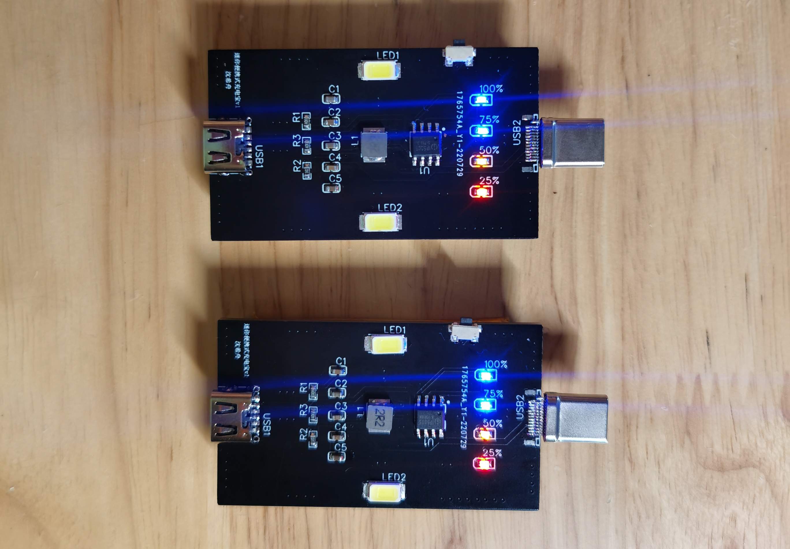

Mini portable power bank v1
Based on the ip5305 chip solution, only inductors, capacitors, and resistors are needed to realize a fully functional mobile power solution.
IP5305 is a multi-functional power management SOC that integrates a boost converter, lithium battery charging management, and battery power indicator, providing a complete power solution for mobile power supplies. IP5305 supports 4-light, 3-light, 2-light, and 1-light LED indicator display modes. Its light display guidance application is as follows: IP5305 chip 4-light display mode.
The battery cell is 803048 model, 1200mah, 4.44wh.
Also equipped with dual LED lighting.
After testing, the Honor V30pro can be charged to approximately 20%.
