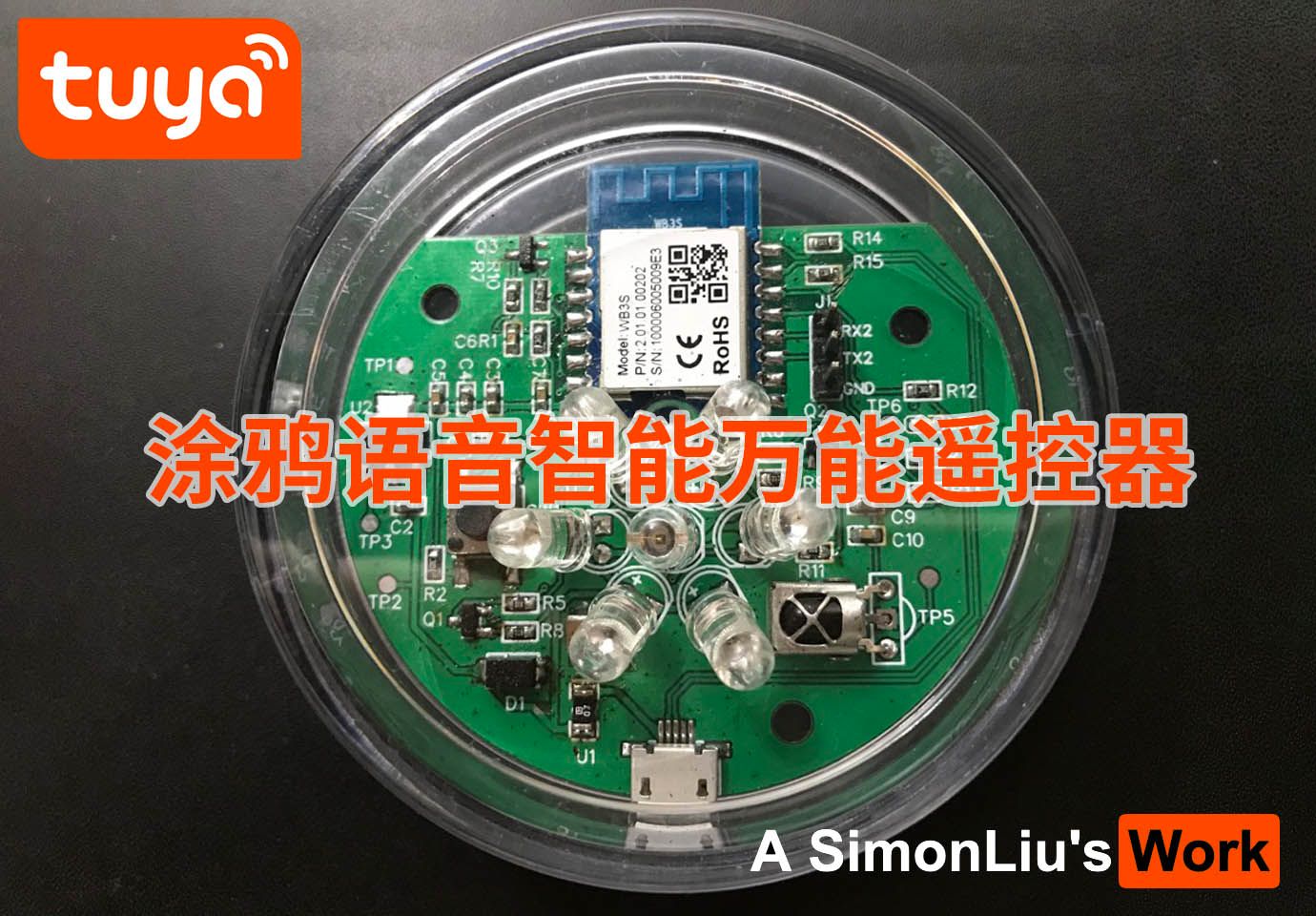

Project Introduction
This is a learning omnidirectional infrared universal remote control based on the Tuya module that can control a variety of home appliances with voice (activation of smart speaker control requires payment, 5,000 yuan is too expensive for individuals, but voice control can be achieved through Siri shortcuts ). Features:
  1. Omnidirectional remote control
  2. With learning function
  3. Firmware development-free
  4. APP development free
  5. The power input adds a protection circuit
  6. USB uses differential lines to lead out RX/TX to facilitate access to production test tools
  7. After activating value-added services, it supports multiple smart speaker controls.
[Link to Tuya IoT development platform] https://auth.tuya.com/?from=https://www.tuya.com/cn/&_source=cbc30f99f7a6c4aebca6755c2fab437f (contains detailed development documents)
Key component selection
Master chip
The main control chip is Tuya’s WB3S. WB3S is a low-power embedded Wi-Fi+BLE dual protocol module developed by Tuya Smart. It consists of a highly integrated wireless radio frequency chip BK7231T and a small number of peripheral devices. It has a built-in Wi-Fi network protocol stack and rich library functions. WB3S also includes a low-power 32-bit MCU, 1T1R WLAN, a maximum frequency of 120MHz, built-in 256K SRAM, 2Mbyte flash and rich peripheral resources.
Infrared reception
The infrared receiver chooses the common HX1838 to realize the learning function of infrared remote control.
Infrared emission
A total of 7 infrared emission tubes are designed for infrared emission. The layout is that six of them circle around and emit diagonally upward, and one in the middle emits directly upward. This achieves omnidirectional coverage of the device obliquely above and directly above. The infrared emission circuit refers to the reference schematic diagram provided by Tuya. If calculated according to the forward voltage drop of 1.4V, the instantaneous current of a single channel will reach 220mA (total idea). Test it first, and then consider lowering the current later.
power supply
The most commonly used power supply is AMS1117, which provides 3.3V voltage output for the system.
Input capacitance
I used a 100uF chip ceramic capacitor here to support the instantaneous large current emitted by the infrared tube. The measured capacity is sufficient. If you switch to electrolytic capacitors, it is recommended to use capacitors above 16V 470uF.
protect the circuit
The protection circuit part is designed with a self-restoring fuse and a TVS diode to achieve overvoltage and overcurrent protection.
User interaction
User interaction consists of the following two parts:
  • One button allows users to activate the network distribution function.
  • One LED indicator light, used to display the distribution network status.
designing process
After the schematic was completed, there were basically few changes. Originally there were no test points, but later test points were added. The biggest change is the PCB. The original version wanted the button to be placed in the middle, which resulted in the module and infrared transmitter tube being placed on both sides of the board, and the module antenna was not on the edge of the board. After repeated consideration, we finally decided to place the module in the middle of the upper edge of the circular PCB and cut off the PCB at the height of the antenna. This made the board much more beautiful. Later, a 0ohm resistor was added to the separate infrared emission tube to facilitate the adjustment of the emission tube current later.

The shell is a bit of a headache. A decent shell from a certain product costs 27 yuan including shipping! 3D printing with transparent resin costs 100 yuan+! This price is too unfriendly to retail investors. You have to know that the finished graffiti universal remote control on PDD is only 28 yuan, and shipping is free! So I thought hard and searched for a long time, and found a more suitable thing: a powder box commonly used by girls. PDD is only 4.5 yuan with free shipping. You just need to make the holes yourself.
Physical map
Penetration test
Signal strength: Measured to be able to penetrate a TV cabinet made of frosted glass
speech ability

After the welding was completed, I found that the board still had some regrets:
  1. After adjusting the angle of the infrared tube, there is some interference with the buttons. In the next version, you can consider canceling the network configuration button or adjusting the size and position of the button. (The current document has been adjusted)
  2. There is a problem with the rotation angle setting of the infrared tube in the upper right corner, which makes it difficult to adjust the direction. It needs to be improved in the next version. (The current document has been adjusted)
  3. Tmall Genie can perfectly synchronize all added infrared controlled devices (one TV and two set-top boxes), but it cannot operate the set-top box buttons with a delay. However, Xiao Ai can only synchronize the TV, but the set-top box cannot be synchronized.
