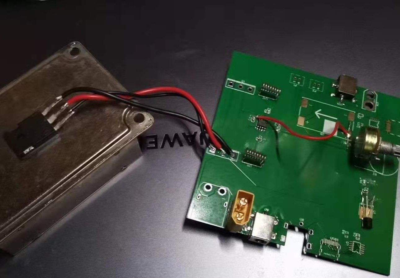

LM358 dual-channel electronic load, single channel 5a100w, dual channel 200w
The input includes xt60, dc5.5, typec deception pd protocol,
Power supply also includes typec-pd, xt60, dc5.5
It has two 12v fan outputs to dissipate heat to two pipes respectively. I welded the pipes to the vapor chamber to dissipate heat. However, it is not recommended because the vapor chamber may explode and injure people. An ordinary heat sink is enough.
