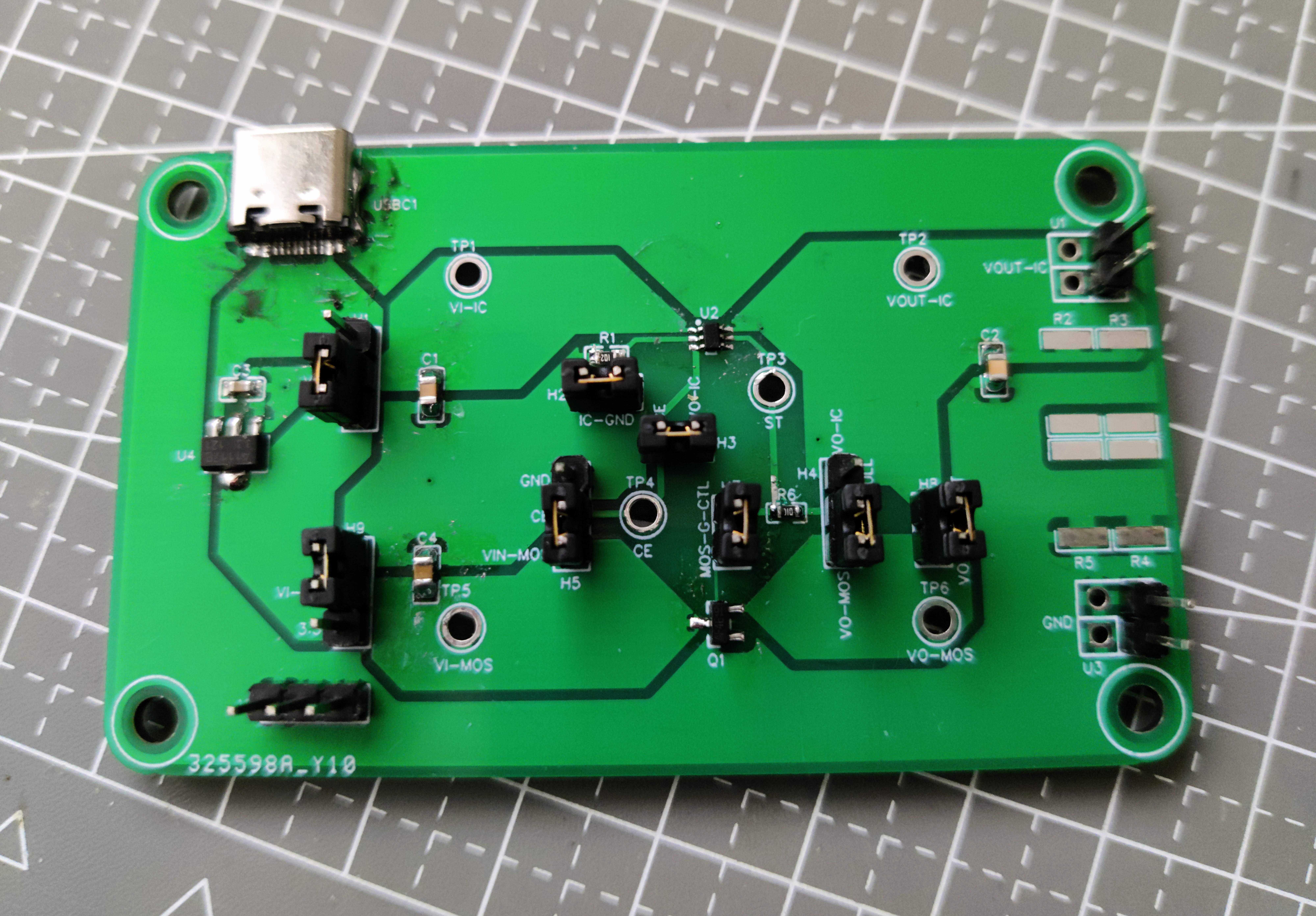

This experimental board is only to verify the feasibility of the ORing circuit built with LM66100 and has no other functions.
illustrate
1. Function
Two power paths
  • LM66100 channel
  • AO3415 channel
Two voltage options
  • type-c straight out 5V
  • 1117-3.3 converted 3.3V
Chip function pin switching
  • CE connection selection (channel 1 output, channel 2 input, GND)
  • ST connection selection (MOS-GATE on, off)
  • ST pull-up selection (channel 1 output, channel 2 output)
  • GND pin connection selection (series resistor, direct grounding)
Measuring point
  • Channel 1 input and output
  • Channel 2 input and output
  • Chip CE, ST
load
4*2512 chip resistors in series and parallel
2. Interface
  • TYPE-C power supply
  • Voltage output pin header
  • Ground pin header
