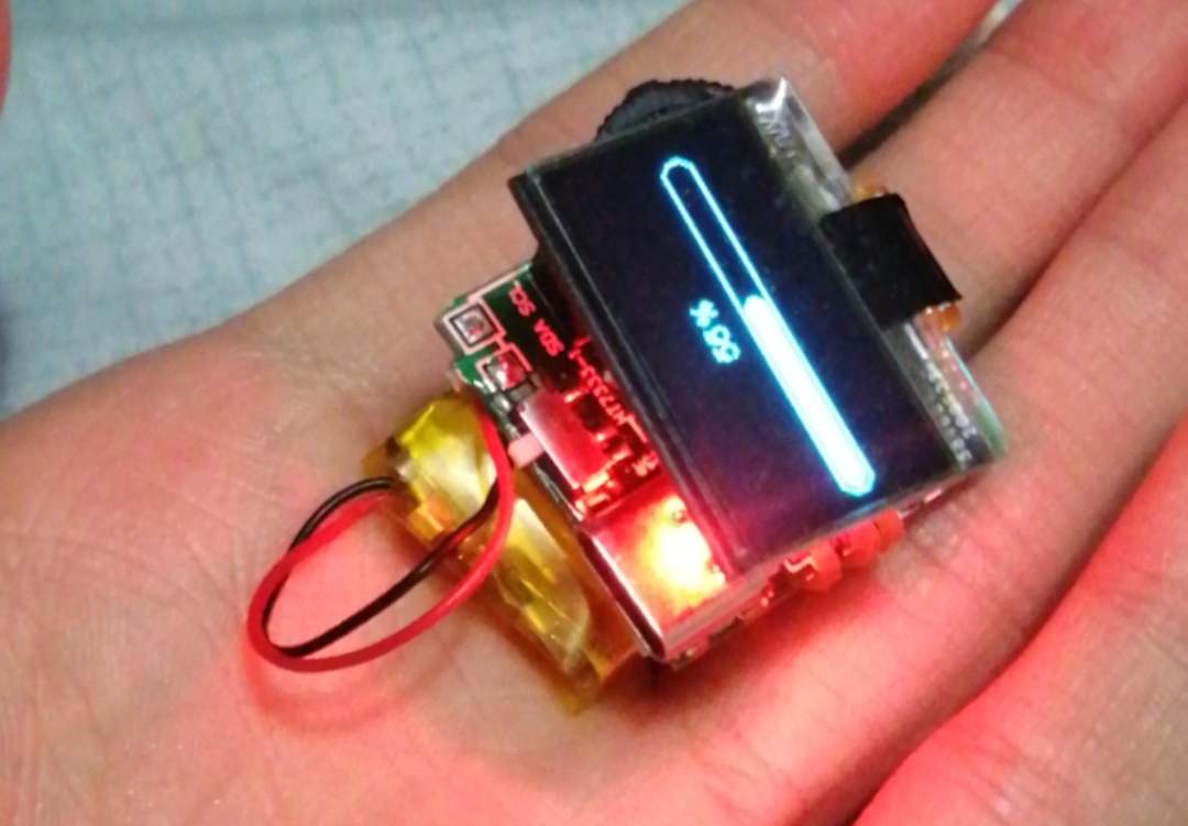

Actually, I really don’t want to call it Wifi Killer 2. The project is clearly called Wifi Killer 2.
ESP8266 Deauther Version 2
But rumors are spreading, and no one would know what it is.
  1. I am minimalist, and the PCB size is 2.5cm*2.5cm.
  2. Use type-c.
  3. Onboard battery with lithium battery charging protection. TP4056, I don’t know what to think. This PCB is very expensive, and the esp12 still takes up part of it. TP4056 is still used, maybe to ensure charging efficiency.
  4. Using 12864 OLED.
  5. Use the toggle switch.
  6. Use ht7833 voltage regulator.
  7. Use esp12e/s/f, no more than PCB.
  8. Burn using burn points.
  9. Onboard WS2812.
Of course, the most famous small TV is Zhihui Jun 's small TV, but the cost is too high and it is not accessible to ordinary players. There are many open source small TVs based on esp8266 and 12864.
It just so happens that I have a lot of both of these, so I came to take advantage of the popularity . (In fact, the popularity has been gone for a long time.)
A dial switch has been added, which makes it easy to perform many operations, such as switching pages, etc., and is compatible with the functions of deauther v2:
You don’t need a mobile phone to test this thing. You can test it offline. It has WS2812 onboard, which is very nice.
Thanks to Tai Chi Maker and spacehuhn
About the code: When using Tai Chi Maker's code, I found that the API version used was too old and the service provider no longer provided it. I modified it into a new version. However, because the computer hard disk was damaged by static electricity, the code was cooed first to ensure that it would not be abandoned.
